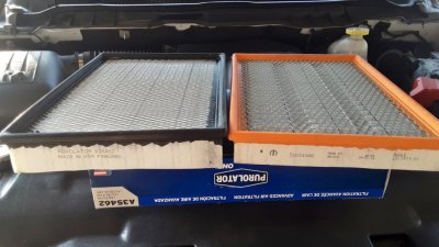

Are you using a reusable/cleanable air filter? I'd put in just a standard paper filter and see what happens.

Just a thought. Maybe they don't really get that clean and eventually restrict air? New disposable ones are cheap, I just got a Purolator One at Pep Boys for $15, and it's thicker than the stock one as well. I kept the original over 25K miles and it's fairly dirty.
