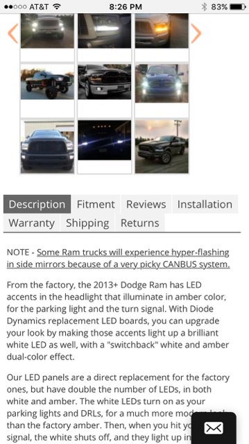

I have a set of lights with diode dynamic boards and of course my luck is that the mirrors hyperflash. It's all installed correctly and DD even has a disclaimer on their website for the product which reads
"NOTE - Some Ram trucks will experience hyper-flashing in side mirrors because of a very picky CANBUS system."
