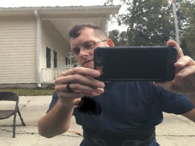

CD1D48BB-770D-439E-9769-8D450CD53546.jpeg Most polishing jobs will make the paint look better than the factory. Its hard to get people to believe this but time and time again i have proven this. Roughly what is involved is making sure the paint is completely free of contamination before taking a mechanical polisher to the paint. This is generally done via a clay bar after the vehicle is washed with a good stripping soap (i use dawn). Once mechanical polishing starts, this is where experience comes into play. Some paints just react differently once the polishing starts. Finding the right pad/polish combo is important, but finding the correct technique and pressure applied is equally as important. Here is a pic from a job i did. It was a Toyota Tundra. The paint was in pretty good condition but did have swirls and just lacked that general pop. That black spot that looks funny in the middle is me covering up a name on my shirt.
