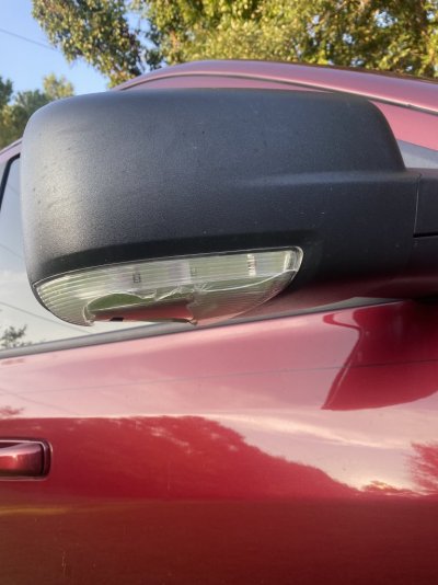

Hey guys, I appreciate any help. My wife noticed the underneath light lens on the passenger side mirror has been busted. Less than three weeks with the truck (2019 1500 Classic but new to us). Does anyone know where I can find a part number? I'll look up vids for replacement. But Mopar isn't giving me a "mirror" at all in searches. So I have to be calling it something wrong. "Exterior, eastside reflective device illuminated for nocturnal departures of your purchase"? I haven't tried that one yet. To be open. Passenger mirror lens.jpeg

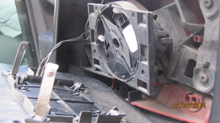

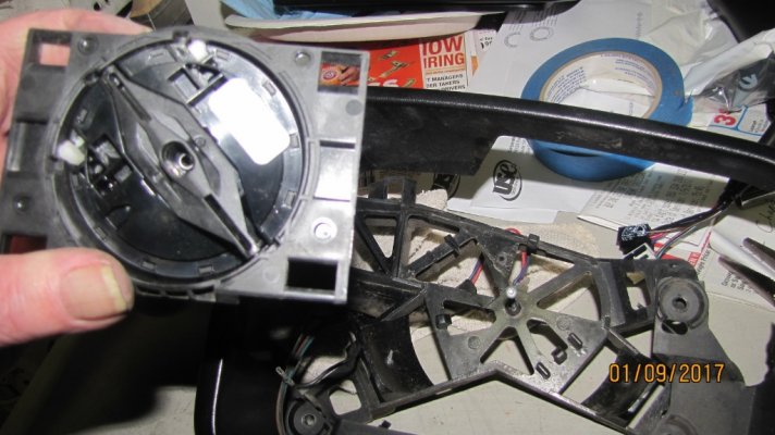

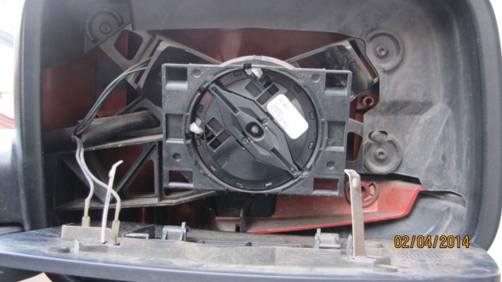

Rotate the mirror glass down
I use gloves for the next part
Insert 2 fingers of each hand behind the top of the mirror glass
, put your thumbs on the mirror glass face
Now give your fingers a slight tug, the upper clips on the glass should release from the upper clips that hold the glass to the electric motor behind the mirror glass
It may take a 2nd tug, just a bit harder
When the upper clips release, look behind the mirror glass to see how the 2 lower clips release, i think it is wiggle a bit as you are lifting
You will then disconnect the wires & set the mirror glass aside
Now look at the bottom of the outer housing, some where near the center, you should see a clip that needs to be moved aside just enough to work the bottom light out.
Clean the area where the edges of the light will fit to the housing
If you look at the inside of the housing, you can easily see how to remove the mirror motor, if you ever have to
Good Luck

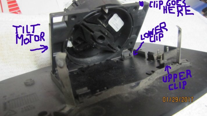

Hey guys, back again. I've finally made time to replace the puddle light. I won't bore you with the why I'm just getting to it. I'm in law enforcement... Anyhow, I'm down to the last step of putting the mirror back in. It won't go. What am I doing wrong? The lower clips are matched but the metal clips up top? Where do they go? Appreciate any insight.

10-22. Cancel that. I found the snap in clips on the back of the mirror go into the square box. The metal clips ride the diagonal pieces behind the square box. Hope that helps someone else's weekend.
