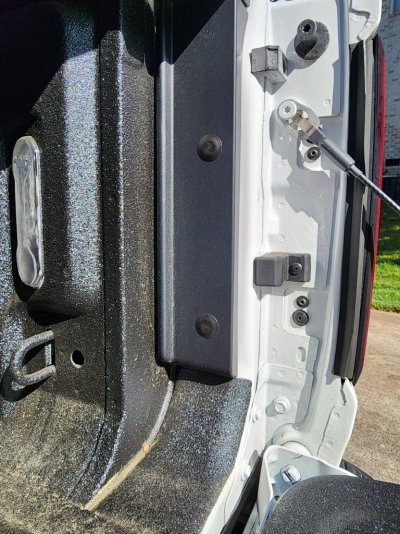

I have a 2022 Rebel with Ramboxes, and it comes with the factory bed divider/extender. I just noticed that the mounting points for the bed extender is missing. Is this a factory goof up, or am I missing some kind of option?20230517_170323.jpg

Can’t tell by the pic, if they are there they would be higher up than the pic shows.

That is exactly why they removed it. You have to order mounting brackets yourself if you want to add it or just use as divider.
From what I remember is you need part # 68054996AA for the swivel and 68054997AB for the inner grommet. You will need 2 each for both sides.
My brother works for ram so I get parts pretty cheap but if you don't want factory and save look at Amazon I think when I looked they were selling kits for around $20.

“Please note that the tailgate release handle and grommets are intended for D.S only, NOT to be used on DJ or DT. Installing it onto the 2019 or later DJ and DT trucks will violate lighting obstruction requirements

Yep, you have to buy and install your own. I had to do the same.

We just bought a new 2500 Limited with Rambox before Christmas and didn't notice the lack of mounts for the bed extender until we went to use it.
Does anybody know whether the bed extender problem was just with the US DOT or did the Canadian MOT also have a problem with it?
Can anybody confirm if the attach points (nuts, threaded inserts or whatever) for the posts are still part of the box from the factory?

Yes, they are still there. I also have a 22 2500 Limited. I bought this kit for mine. No complaints.

Once you get the parts, you simply remove the 4-plastic plugs and insert the bolts, and you're all set.
