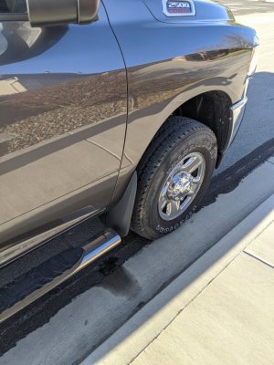

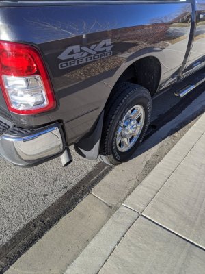

I have the Husky mud guards. So far I'm pretty satisfied with them. They definitely help with the water and mud that was constantly getting thrown down the side of the truck. I think I paid about $75 for front and rear.IMG_20191227_145029.jpg IMG_20191227_145015.jpg

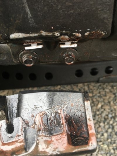

I popped the front mini mud guard off to clean the cinders out. I suspect these will be a problem for the salt states. Once you take the two 8mm screws out these just pop out with a tug out from the vehicle. Cleaned them and the fender off with a quick detailed. I did not do the rears as they didn’t have nearly the amount of goo in them.

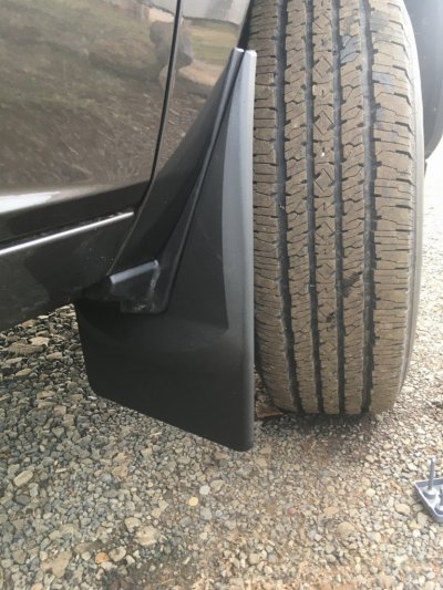

Front installed.

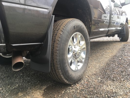

From the rear with the rears installed.
I really like how well these integrate into the stock fender liners and mini guards. The front flaps have a tab that secures them to the fender liner. The rear flaps have a tab that secures them to the rear mini guard. The rear also has a spring clip that clips the inner wheel well liner to the flap.
