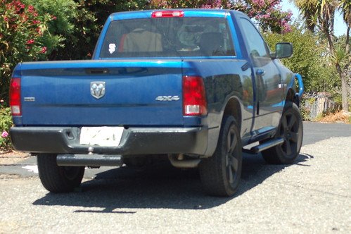

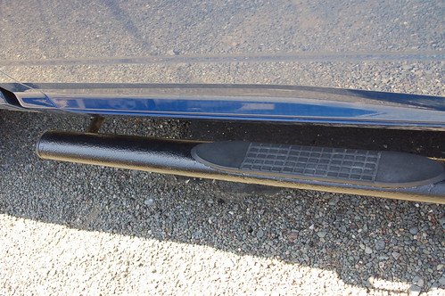

So less then a week my tubes plastidip was getting scratched off so I went through hell to get all the dip off and monstalined them. I'll post some pics and an intro, and in a second post I will discuss the pros and cons of both for those who might be interested, as well as some tips if you monsta line something. I took a lot of photo's so guys will really get an idea what this stuff looks like before choosing it. The colored version of monsta liner is much more popular then black for exterior surfaces, so if you are thinking of a colored monsta just go for it, they always look nice. The black is real black, but gets matte overtime just like LineX.

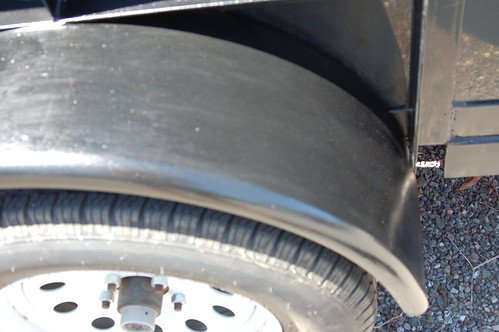

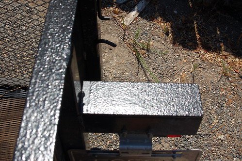

I did some of my trailer as well, I painted the wheel wells with a brush for fun so you can see both textured roller look or brushed on. You can spray monsta as well, but even that adds texture. Monsta is no good for a smooth look, one weakness if you want the powdered coat look like plstidip can give you.

I'm sorry but that looks horrible imho... The texture just ruins the look for me.
Dip isn't meant for high contact areas like step bars. It would have been fine on the bumper if you applied it correctly(assuming you didn't since it didn't peel off in one piece).

That is exactly why I posted, not to say hey look at me this looks great, but rather to show guys what monsta will look like for guys considering it. This ugly chiet suits me to the bone, but that's my opinion. In a couple weeks it looks just like LineX, which guys also don't like except in their bed.
Let it be known I aint the fresh prince of bel air, this is what my tubes look like most of the time. I haul loads every week and this truck is used at my sky ranch for all the work needed. We order our hair cuts number 2 out here because we don't have the time or inclination to brush it. Plasti dip aint cutting it.

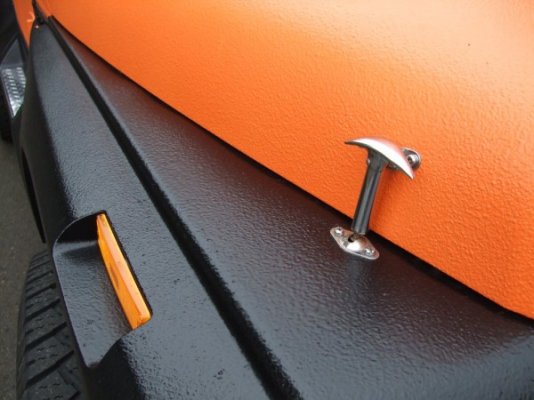

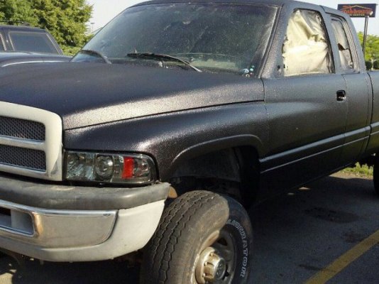

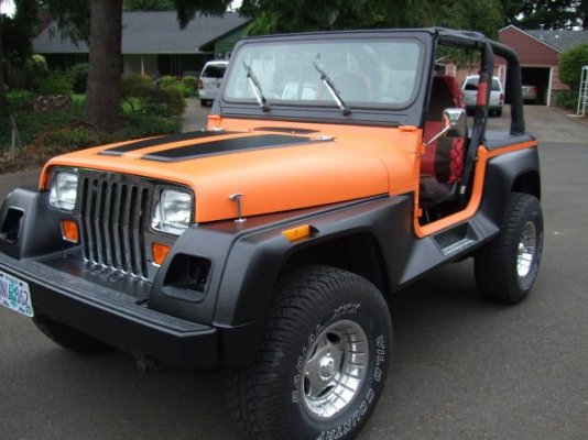

First glance which fender is LineX and which is Monsta? W/o cheating which 1, all of them?
Rzrman328
Aug 25, 2014
5,808
3,153
The treeline
Got me. I think they both are good stuff.
