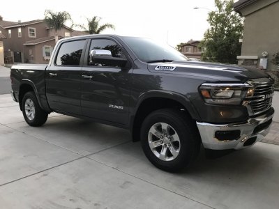

I'm happy with these for now. Much cheaper than putting clear film on the side of the truck. Install was easy, uses factory fender bolts, but only thing is they both also use rivets which require a plastic rivet tool. I didn't have one so just purchased some cheap 1/4" panel rivets from the auto store which works fine. Only thing I didn't like was the front wheel clearance. Factory wheels are fine but only about 1" of space when turning so a larger wheel will likely rub so the guard will need to be trimmed. IMG_8946.jpg IMG_8935.jpg

I tried mudflaps on my last two trucks, but like you said it Limited me in the front.

Mite wanna pop those off now and put some rubber from 3m between the paint and plastic flap. Overtime they scratch the **** out of the paint.

Great tip! Thanks!

Are they available for the trucks without the fender flares?
Yes. I bought mine from cjponyparts but I think they are cheaper from Avondalemotors on eBay. Just be sure to check the description for without fender flares. Avondale ships really fast so does cjponyparts
