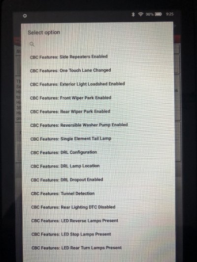

You could try AlfaOBD to change the DRL settings. The only problem is not sure how the truck will react.

AlfaOBD can turn off DRL.

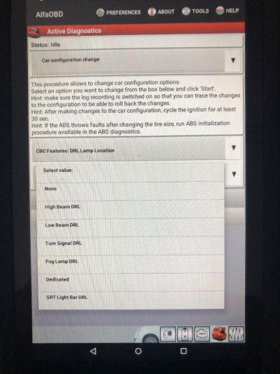

If you are in Canada then you need some sort of drl. I'm not sure if it matters where. If you installed the headlights I believe they came with some sort of fuse tap so the upper and lower led's become your drl's. So technically you could use alfaobd and turn off drl's and still be legal. Or if it needs to be programmed for drl's just move them to fogs if you have them. If you bought a Canadian truck in the states you can use alfaobd and turn off drl's and not worry about it.
Depending on what year truck you have and the wiring set-up on the morimoto's you can add the dedicated drl feed and tie into the drl wires on the headlights and use alfaobd and set drl's to dedicated and should still be legal in Canada

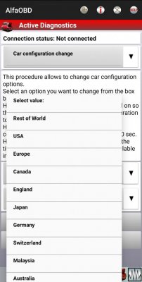

There are some options to change country code at the beginning of the list. My concern with his truck is will it freak out or not turn off the DRL because of other settings.
There could be no consequences changing it but I wouldn't recommend it yet and find out the guys truck is bricked.

Change the DRL to off and wire it up via the US method with the auxiliary harness going to the fuse box. That should make them behave normally. Or reach out to Morimoto and ask them what they think.

When connected to the bcm select drl lamp location then in the drop down menu select none and that will turn them off but still will be programmed in the bcm

Set the truck to US in country code :cheers:

If you had stock projectors this may be true. But with quad beams there were a few things i had to do, on my 14 to make them work properly.. Also a canadian truck. Changing the country code like someone mentioned is necessary to turn them off.

Canadian trucks with non-projector headlights (dual or quad reflectors) utilize the high beam bulb at a reduced brightness as the DRL. This is why your "brights" are on, and they are flickering because the truck is trying to run them at a lower voltage. Your best bet would be to utilize alfaobd to turn off your DRL's, and then use the provided fuse tap to wire in the Morimoto DRL function. Your other option is to turn the headlights on using the headlight switch every single time you drive.
