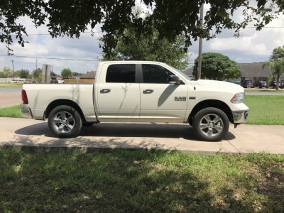

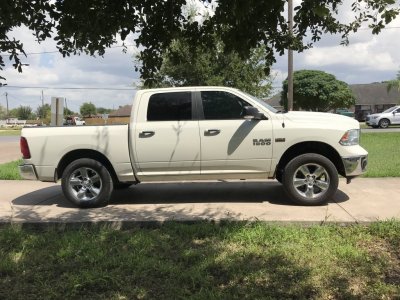

hello everyone! I installed a lift kit that was going to raise my front 2”5 but seems like it lifted the front a little more than I wanted. My ride feels bouncy which I expected, but regarding shocks, is where I’m lost. Any advise is greatly appreciated. Thank you!

Lol....damn that looks like more than 2.5

dont like the ride quality, I’m new to trucks this is my first truck, but at this point wonder if I should just take this level kit off and look into a lift kit with shocks and spring, any advise guys on what or where I can look to order parts. Like I said im new I need some guiding.

After looking at them on ebay they probably sent you the 3" spacers. Honestly i would return them and get some bilstein 5100s for the front and set them at 2.1 or 2.8. That would help with the ride as well. There are a lot of info in regards to long term use of spacers that cause damage just do a search for leveling kits.

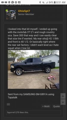

I'm thinking you got a 3" spacer always hard to tell because with spacers it's not 1 to 1 Screenshot_20190807-085127_Samsung Internet.jpeg
