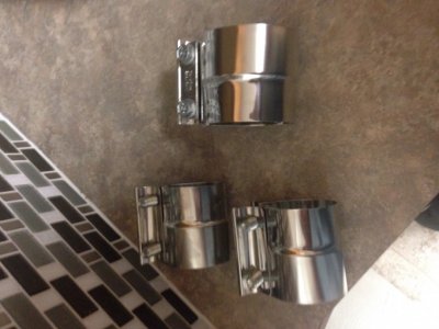

This is the style camps I'm going to be useing for my muffler build here in a few days they are lap band clamps 6.99 ra from jegs. They will probably require slight modification, if I'm not mistaken the exhaust has alinment tabs that I will have to clearence the clamps and pipes for. I will post a reivew after I get my setup done.
