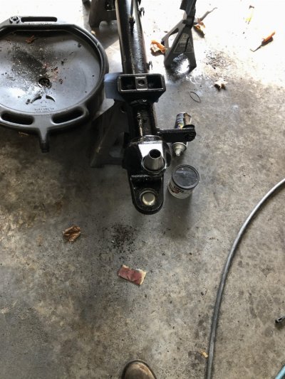

Started on the frame with a wire wheel. Took the shock mounts off and the support braces for the trans mount, also removed the skid plate.

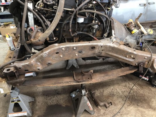

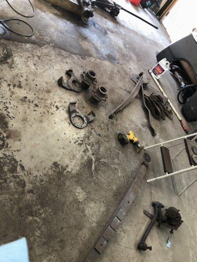

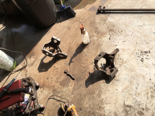

Got the front leaf springs off, cleaned and bushings out. All brackets that I pulled off are cleaned up and started on the front axle. Going to attempt to remove the knuckles with axles attached so I don't have to tear each side down so I can clean up the axle housing easier. Ordered a few parts, new bushings for the front leafs, new shackles, pinion seal, front diff cover (oem replacement) and power steering lines. Would like to get the front axle back underneath the truck soon. I feel a little uneasy having the front end supported by 2 jackstands and a 4x6. Would rather have jackstands under the axle.

Axle tore down and almost ready for paint.

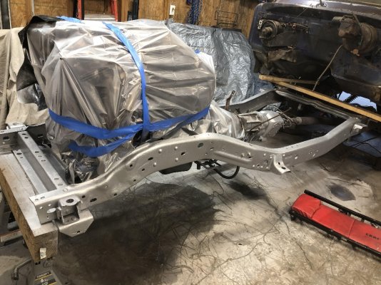

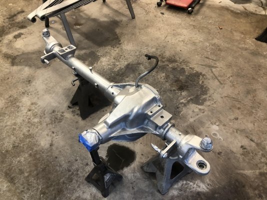

Took a little longer to get everything ready for the first coat, but it's on. Really wanted to get 2 coats on today. I'm using Eastwood platinum rust Encapsulator.

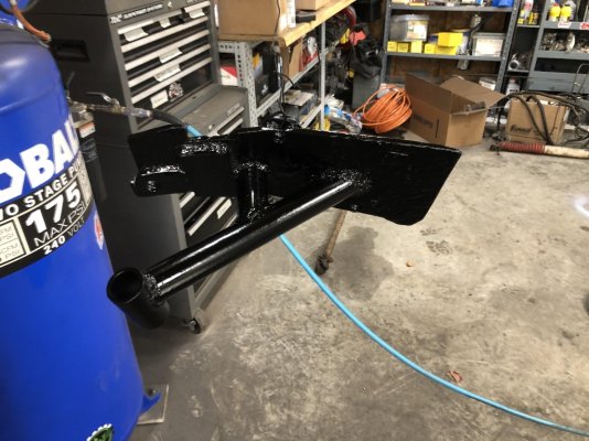

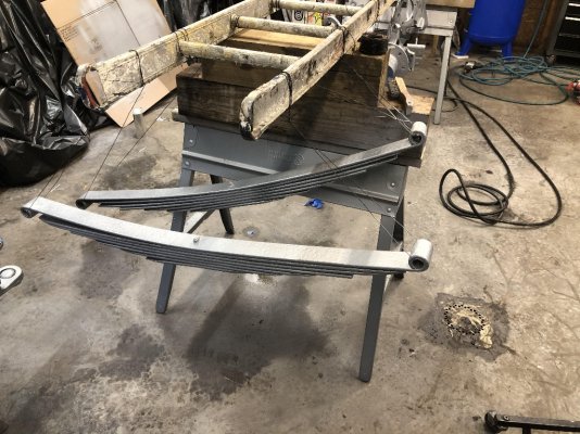

Replaced the leaf spring bushings so they are ready to go back on. Ordered some 1" taller than stock shackles from far from stock. Those came in yesterday. Had just enough chassis paint to paint those and the new front diff cover.
I didn't remove the outer sleeve from the original bushings because they are pretty much in there for good so I'm trying to modify a set I have to fit. Then I can hang the leaf springs. Once that's done going to start replacing seals/bearings on the axle so that can get back underneath the truck.

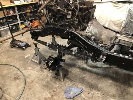

Leaf springs are on with Far From Stock 1" longer shackles. Started on the trans mount bushings. I need to grab some new washers to finish it up. Upgrading any suspension/steering bolts to grade 8.

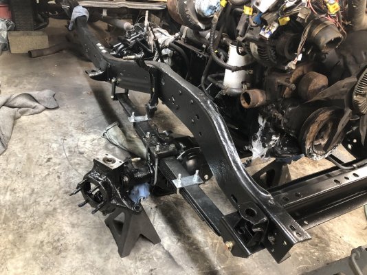

Got the new lower kingpin bearings, races and seals in along with the pinion seal and new diff cover. Had to order a sleeve for the pinion yoke. Had a decent groove in it which would prevent it from sealing properly. Also installed the shock mounts and new leaf spring clamps. These are quite beefy. I may flip them tho. Hopefully will be able to get the axle back under the truck tomorrow. Also got the skid plate back on.

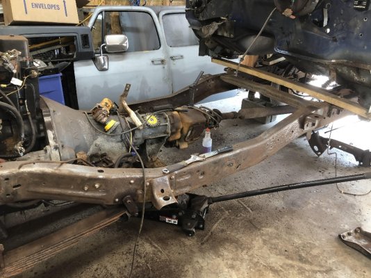

Cab is off. Time to get the rear axle out and start cleaning up the frame

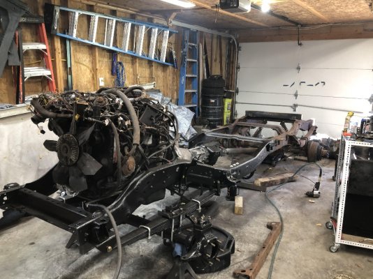

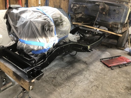

Rear leafs are off along with the rear hangers. They were shot. Going to remove the front hangers also. Driver's side is OK passenger side is on it's last leg. Removed the shock cross member for clean up.

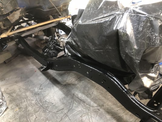

Got the frame cleaned up. Have a few repairs/supports to add towards the back of the frame. Also got the steering box mounted.

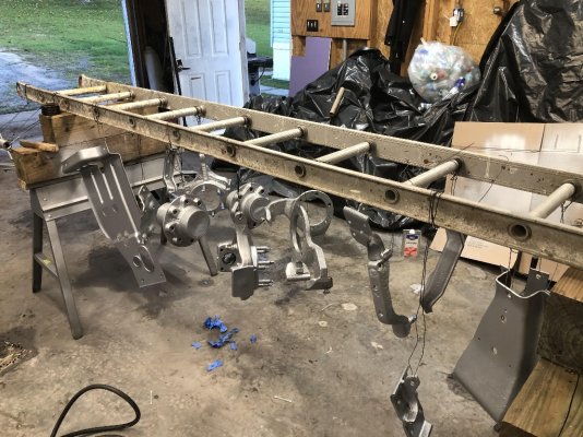

Got the rear axle cleaned up and some of the cross members and blocks.
The front yoke repair sleeve came today so that's on and the yoke is painted.
New dust shields for the front stub axles came. Got those on and painted

Doesn’t seem like I've accomplished much lately. But the back half of the frame, rear axle, leaf springs and misc brackets, cross members and brake parts are cleaned up and ready for the rust Encapsulator and chassis paint. I do have some repairs on the drivers side lower frame rail where the gas tank was. Hopefully have that knocked out this weekend. I did break down and order the rest of the seals and bearings and u-joints for the front end so I can start getting that back together. That just leaves the brakes, locking hubs and the king pin eliminator kit and the front axle will be done. That's going to be a rough ~$800 to swallow when the time comes. But plan on getting the seals and bearings done on the rear axle first.
