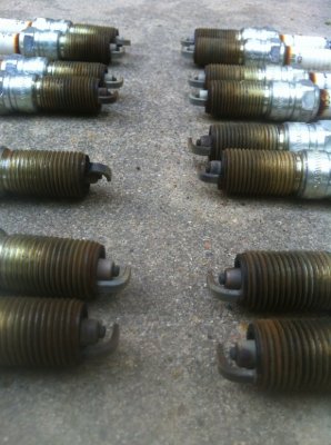

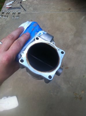

From joining this forum I have learned a ton and now know that my plugs were killing my gas mileage and my truck wasn’t running super smooth. I had 103k miles on my stock plugs. The gaps in the old plugs were all around .065 and new ones I put in were set to .044. My throttle body didn’t come out spotless by any means, but I did get a lot of the old crud out.

And as far as the throttle body goes, slide the red part of the electrical connector all the way to the LEFT. This will allow you to slide off the connector. I also used a walmart bag and some tape to help prevent any brake cleaner from getting into the electrical parts of the TB.

Here's a pic of my old plugs!
