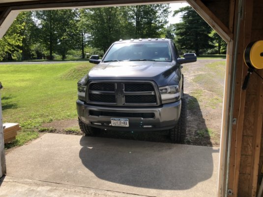

And grill is done
2018 2500 6.4L Tradesman
Did you paint the bumpers and grill? What did you use the rust oleum peel stuff? Looks good, I hate chrome but don’t know if I want to use the peel stuff again. (Different vehicle)

The rustoleum stuff I only used on the badges because I'm not sure what direction I want to go with them. I did paint the bumpers myself.

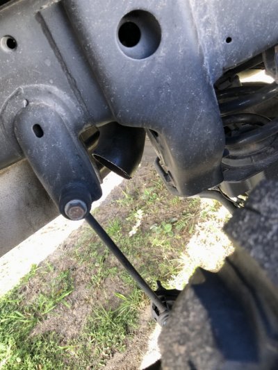

A little update. I cut the tail pipe section off that I made when I had removed the resonator. Got rid of 98% of the resonance that I was getting at 1600-1900 rpm.

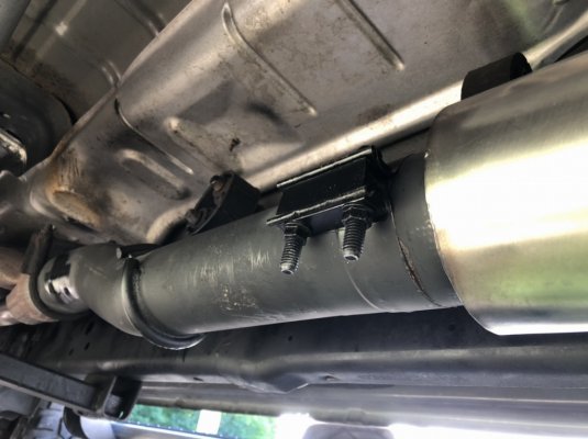

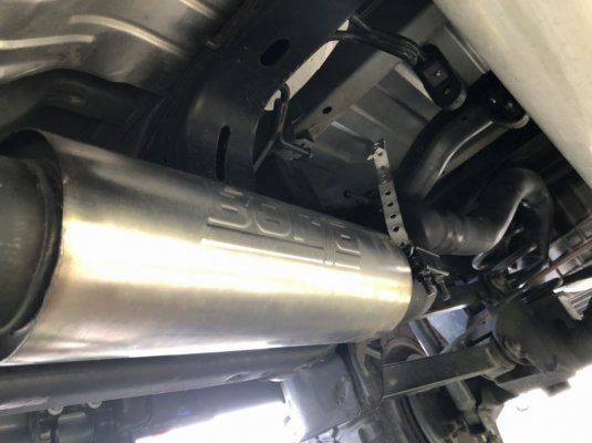

It was kinda tough getting good pic's but hopefully these help
This is where I cut the tail pipe section off that I made. This is where the inlet of the resonator would be. I do plan on adding something he to direct the exhaust down more.
Here is the bend I had to make using the 2 42 degree pipes I got from summit racing. Don't mind my "hanger" it's not doing anything right now and have been to lazy to remove it and the clamp. I plan on ordering some weld on hangers.
https://www.summitracing.com/parts/dtc-780-42351/
The inlet side
The inlet side and where it connects to the existing tailpipe are clamped on. The bends are welded and those are welded to the outlet part of the muffler. For temporary hangers I used some galvanized pipe hanger bolted to the clamps and to the existing hangers on the truck

I was going to put the resonator back on if cutting the the tailpipe section off didn't help. But since I don't have anymore drone and it actually sounds better I'm not going to worry about it. Plus I like the look of no tailpipe. I think it looks cleaner
