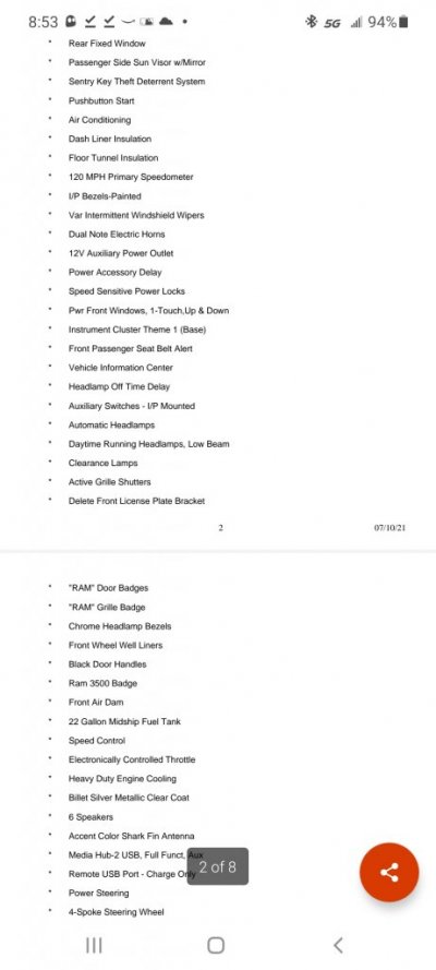

Here is where the 52 tank should be. It looks like the 22 is and on. Any idea how I go about getting ram to put the right tank on it?

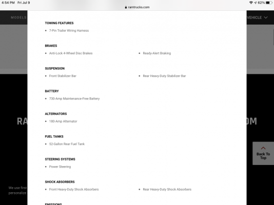

According to Ram’s build a truck tool, it says 52 gallon is standard equipment with options for mid tank 22 or 52 dual tank setup….

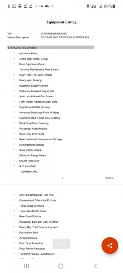

When I ordered the truck it doesn't come with a vin. My window sticker and initial build sheet I signed, 100 percent does not list a gas tank size.

Your second screen shot lists a 22 gallon midship fuel tank.
And under standard equipment, so surprisingly the 22 gallon tank is apparently the stock tank. Learned something new there, but yeah that's pretty small for that kind of truck.

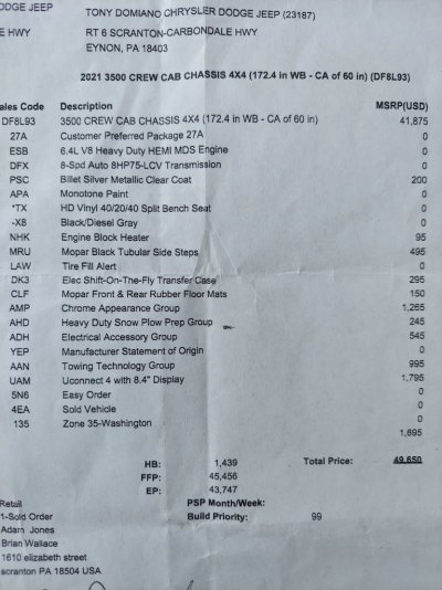

That was a screen shot of me putting the vin into the log in today that another poster helped with. Today was the first I saw this. Like I said it did not have a VIN. It had VON. Here is what I chose at the dealer in March. No gas tank on it.

Bottom line IMO is it should have a 52 standard and the 22 is the ADD ON.

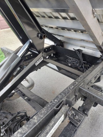

A bit late to the party but figured I'd chime in with my 2 cents. Bought a 2016 Ram 3500 Crewcab 6.4L with the Aisin trans, 4.44 gears and a sweet Eby flatbed. Lo and behold it had the 22 gallon tank. Ram told me that any truck (cab chassis) with a aftermarket body automatically has the 52 gallon tank deleted and the optional 22 gallon installed. They didn't want to get involved with helping me add the 52 gallon tank. Long story short I bought slightly used 52 gallon tank (skid plate/mounting bolts) from a guy in NC that had to remove the 52 to mount a wrecker body. And it bolted right up. He had to revert to the 22 gallon. Had to fabricate some parts to install sending unit and plumb supply/return lines, etc. Used an Airtex pump, Goldenrod filter and Autometer fuel gauge on A pillar. So 74 gallons of fuel onboard. At least now I pass a few gas stations between stops. Been working right for years.
