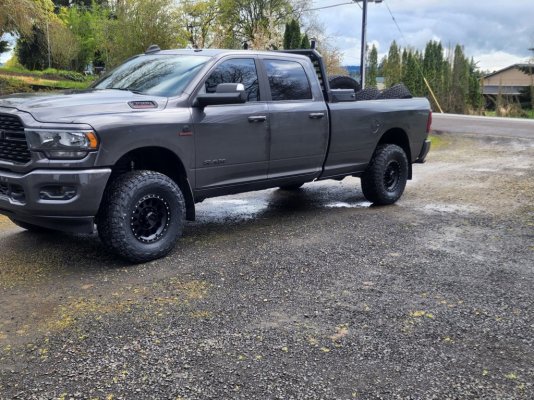

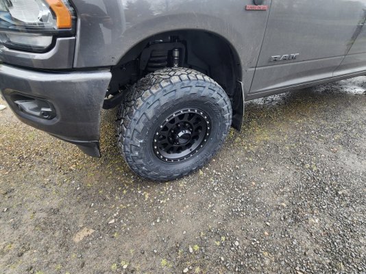

New wheels and tires.
Cjc addition method racing 17in wheels.
35x12.5r17 Nitto recon a/t

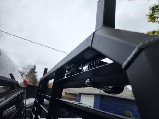

Had some spotlights sitting on the shelf so added them to the rack. It took me about 2 hours and a few beers but ran all the wires through the rack and drilled a hole to run into the front stake pocket. I added plugs in the pocket so I can remove any time I need and not worry about wires.

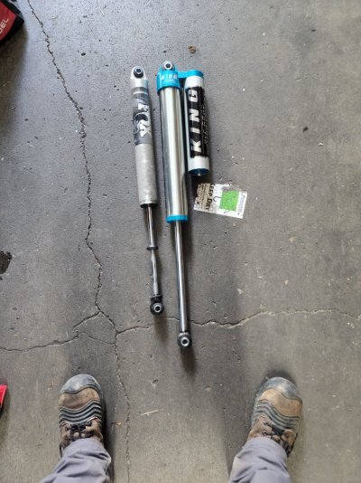

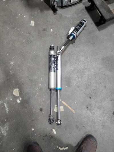

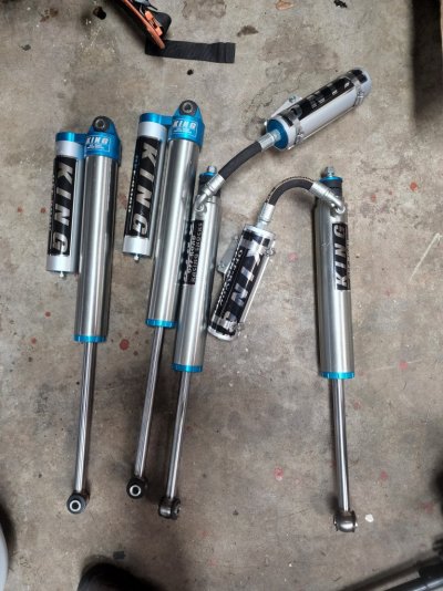

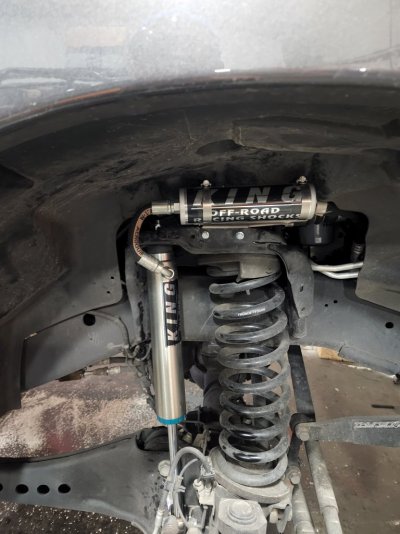

Found a good deal on thuren tuned king 2.5 stage 1. We will see how they compare to fox 2.0 :p

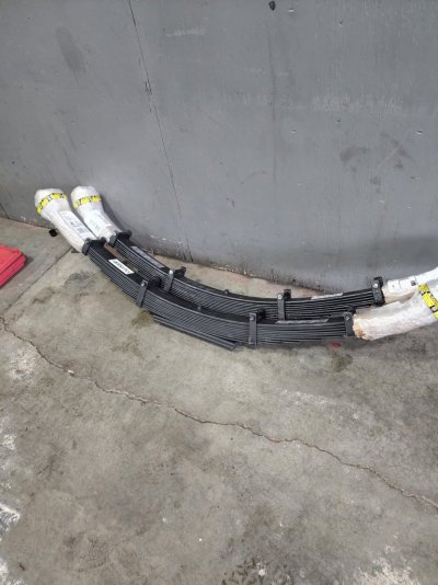

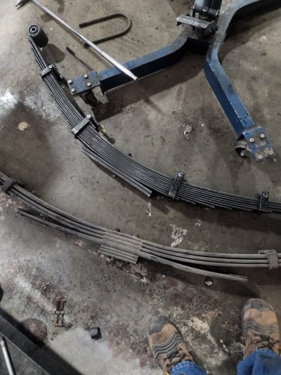

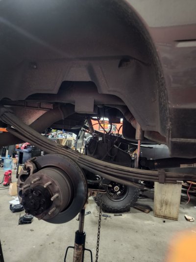

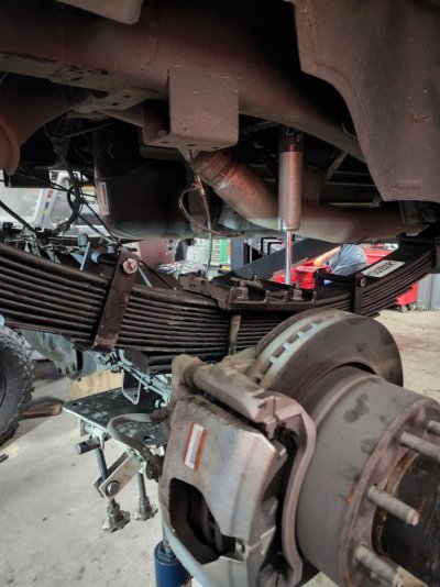

Install awhile ago been trouble shooting them and finally got then to ride nice. Thuren progressive rear leaf springs these take bumps pretty good a lot better than stock. When I first installed them they were really jittery and I did not like them at first. We loosened the bolts and re torqued quite a few times and the spring pack finally loosened up. Overall happy the way they turned out hopefully they break in better over time. Going over speed bump you do not get a double bounce just a single soft thud definitely a lot more axle movement.

I was going to go pick them up as well I am in Hillsboro oregon but no time and with fuel price shipping was the best way. My buddy ordered them and he is now a authorized thuren dealer. We did install the thuren shackles as well and I almost returned them all. We fought them after install out of the box they were very stiff and bouncy. Every little small bump was all jittery and big bumps were very stiff. We loosened bolts and re-torqued over and over. I have about 2500 miles on them now and they are a lot better. Thuren said I can run them for 6 months and if I am not happy the will give me full refund. I am content with them now and I am sure they will loosen up. If you want let me know we can meet on a weekend and you can drive my truck to see if you like it. Just keep in mind the 5th gens sit 2in lower than the 4th gens thuren rear leaf spring will raise you up about 2in and 2.5in without shackles. Ordering shocks you will want something a little longer than stock to accommodate them. My 3500 is full thuren set up active sway bar, king steering damper, 1.75in level, track bar, shocks and rear springs/ shackles. I actually want to find a stock truck to compare as I forgotten how a stock truck rides lol.

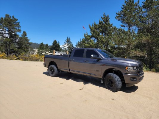

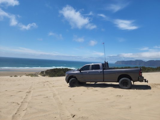

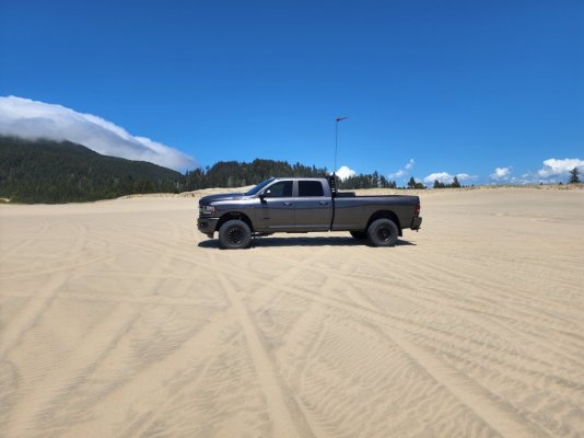

Tested out my Thuren suspension today. As much headache I've had with the rear springs it's definitely worth it. Never bottomed out the suspension and I hit some pretty big bumps. It's pretty impressive over all for being a heavy truck.
