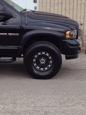

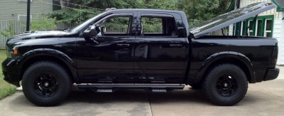

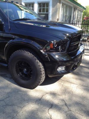

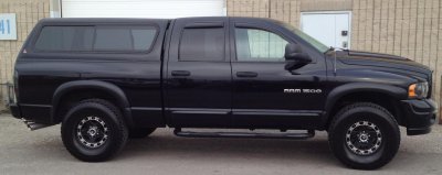

Just talking to FastNugly, said a couple of guys wanted to se 37's on a leveled Ram, I have a Ready Lift, 2.5 inch billet spacers, tires are BFG 37 x 12.50 x 17 on American Racing ATX Atillery wheels with a -12 offset, I have mild rub at full lock left, there is a spot about 4 x 4 on the inner fender that sticks out, thats what I rub on, I can either cut it out or I also have a set of 1/4 inch hub centric spacers I could put in to eliminate the problem, here are a couple of pics, sorry, not trying to highjack your thread

That wiil have to wait till am, never had a need to actually show tire size as proof, I don't make it a habit of BS'ing, one question though, how do you get close enough to show tire size and still stay far enough back to show they are actually mounted??

That's a good question. I was just curious, not saying you aren't being truthful, just never heard of any brand of 1500 fitting 37's on a level.

This was my thinking, I had an 05 with 35's and just a level, my buddy had 37" mud terrains on his 03 with just a level, he too only had mild rub, the 12's wheel openings are definately larger so I thought what the hell, I have a buddy who is the parts manager at a Dodge dealer, they had a set of 37" AT's for half price, so I took them, I figured if they don't fit I'll just raise the truck, I put them on my new wheels and they fit, very minor rub at full lock left, by going -12 offset I also wound up with an overall change of 31mm since stock wheels are +31 offset, as far as gearing goes, I'll just put in a set of 3.92's which will pretty much restore my factory ratio with 3.55's
33" tire x (3.14pi) = 103.62" divide by 3.55 gr = 29.19" per drive shaft rotate
37" tire x (3.14pi) = 116.18" divide by 3.92 gr = 29.62" per drive shaft rotate
So I can live with getting beat off the line, with my bottom end, I'll just catch you further down the road, and I will also enjoy half decent fuel economy
