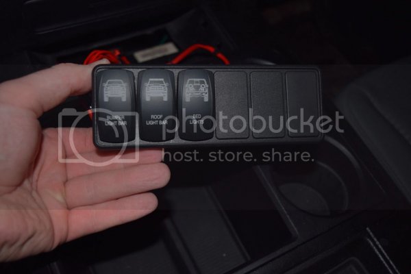

I got tired of the lack of aux switches on most of our trucks, and after a lot of searching I found a switch panel that would work with my plans for the truck. After some deep thought I decided that my panel would need to hold 6 switches to do everything I wanted once I am done with everything. The switch panel and swithes were sourced from OTRATTW . They have switches for every possible application you could think of, and if they don't have what you are looking for then they can custom engrave what you want.

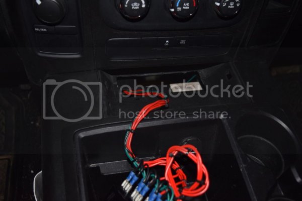

I went with this location because I only toss my wallet there when I am driving so its pretty much wasted space to me.
I had to cut out the two fastener locations that tie the center dash bezel to the center console top bezel. I used an angle grinder to cut the hole, but only because I don't have a rotary tool.
I then ran my wires through that hole and connected everything up.
The labels come on with the parking lights (and dim too), and the icon lights up when the switch is turned on.
