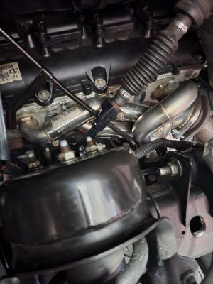

It wasn't all that bad of a job to do. A lift helps a lot. I'm not completely done. My truck is still sitting on the lift. I did a heat cycle and tomorrow all I have to do is recheck the bolts I got some dei cool tape to wrap some areas and Install the fender liners and it's done I love how they look installed cant wait to drive it

I ordered them from summit racing and I used the remflex 6022 Exhaust manifold gaskets the one's Kooks sent wasn't right the port holes were small and oval and the headers are large and D shaped the remflex gasket fit perfect. Thanks to wild one for the heads up on the remflex gaskets

I finished up my truck today I drove home 20 miles and when I got home I opened the hood and the only heat I felt was from the Radiator radiator hoses and heater hoses I put my hand a ½ inch away from the headers and absolutely felt no heat what so ever this is fact not ******** so Kooks headers do not have to be wrapped or ceramic coated. I'm very happy with the Kooks you get what you pay for
