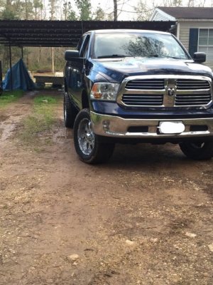

I just got my zone 6" lift (5" rear) finished up. They kept the level blocks upfront which will be coming right out as soon as I get the bilstein 5100's. So far I like it, I've only driven 40 miles on it since I got it back though. Here's a few pics. Still has the 33/12.5's on there for now until I get the new wheels/tires.

JDPERRY your truck looks great! I can't wait for my refund check to come in!

Thanks man, I really appreciate it. I can't wait to put the new rims and tires on!
