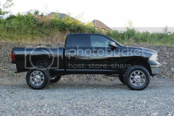

I was running a 6" RCX lift with Bilsteins at 1.4" with 35's on my old 2012 1500. That setup is equivalent to a Zone 6" kit with the 5" rear coils and Bilsteins at 2.1" so your setup would look almost identical to it lift wise.
that's an awesome look, i love it! your a truck dictionary. i was wondering with the bils your leaving out the The preload spacer. but using the strut spacer. what is the difference between them. how would i know what is what.
