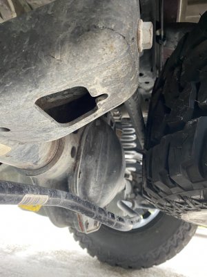

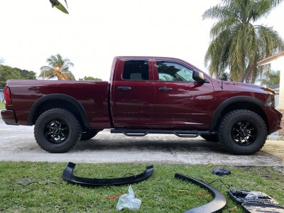

455211DB-A58B-4AF5-B37A-26B9E7046E4E.jpeg 25F8A2EB-9583-4B3D-A871-59326DE3609A.jpeg 35s do not fit. Idk who got them to fit but damn... true 35s do not. And when I upgrade to the core panhard/track bar there will be even less room. This tires at 5psi and it hits the track bar and rear bumper mount.

[QUOTE="crazykid1994, post: 2177908, member: 16248"35s do not fit. Idk who got them to fit but damn... true 35s do not. And when I upgrade to the core panhard/track bar there will be even less room. This tires at 5psi and it hits the track bar and rear bumper mount.[/QUOTE]
Thanks for trying and posting your results. I'm just gonna bed mount the spare on my next set of tires purchase.

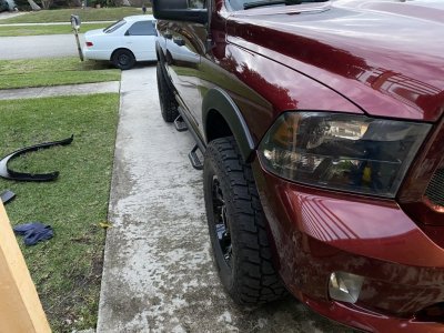

Flares look good! Hard to see exact detail but are they bedlinered?

They are not bedlined. I purchased flares that are a textured black finish. Was going to get some bedlined but waiting to see if I find other flares off a 2500 first. These were cheap so I went for it as a temporary coverage. 220 shipped.

They look good, I did the same on mine. Cheap flares do the job. Keep an eye on the paint along the edge of them. Flares will surely chew throught it quickly.

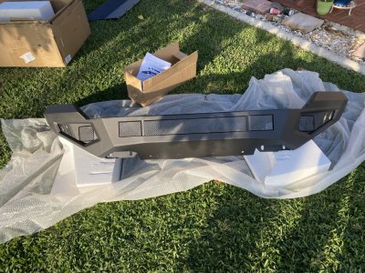

Anyone care to guess what is in this big box?
crazykid1994
crazykid1994
Sep 21, 2013
5,063
5,064
Florida

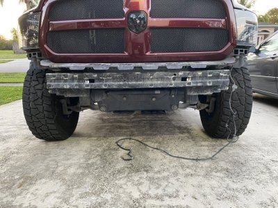

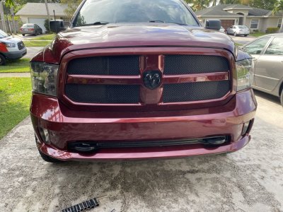

Removed my tow hooks temporarily. This bumper reuses the stock tow hooks which is awesome. Good thing I saved the stock tow hook brackets. Going to be a big difference especially on approach angles. I ordered the skid plate attachment too. It attaches to the lower tow hook mounting point and to the bottom of the bumper itself. Will post pictures of install and finish next week as I’m to busy this week. Need to order some pod lights. Looking for a yellow flood to install to use as fog lights
