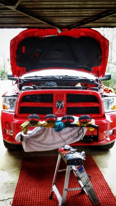

Love the look. Way to buck the trend and go with KC rather than a light bar.

Did unread that right? 5lbs each?!?! What are they, cast iron?

I'm not sure if 10 lbs is for two LEDs,
I will try to find any weighing scale here.
Material used according to Amazon is a Die-cast aluminum housing.
Update:
Dealer replied me the weight, 5 lbs each

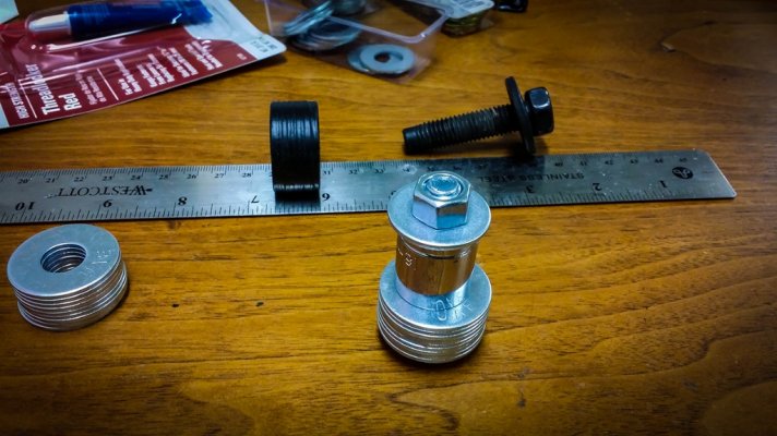

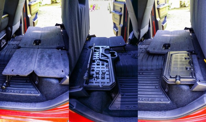

DIY: Rear Seat Flip Down Mod

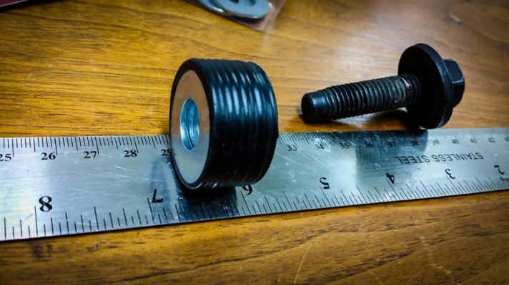

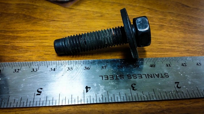

Rear Seat Mounting Bolt
Spacer...
Washer ID: 1/2 inch or M12
Spacer Thickness: 5/8 to 3/4 inch
Modified Bench Picture: Pending, too dark outside :roflsquared:

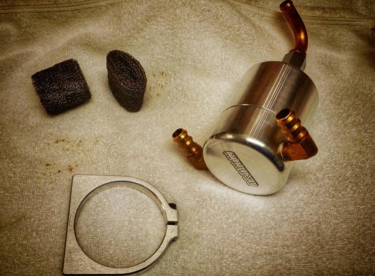

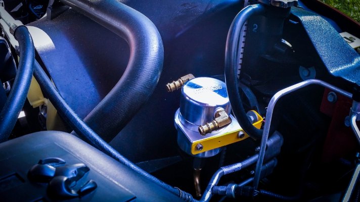

Lucky me I found Moroso OCC(used) from Ebay with lower good price.
Checking, cleaning and polished...

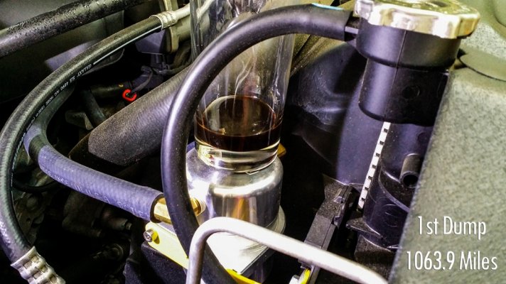

Oil Catch Can Installed
[yt]3VBPSpp8Ll0[/yt]
Stock PCV Hose retain.

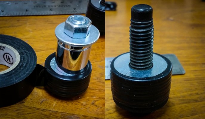

Spacer...
