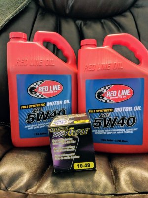

My Redline oil just arrived!

Isn’t t supposed to be 0w-40, or did I miss something?
What 0w40 is in the terms of what FCA is doing is really a 5w30, as in collusion between oil manu's and auto manu's to skirt gov't rules on 20 and 30 weights. The info has been posted in syn thread, find the API pdf if you are interested probably with in the last 50 pages. The 0w40's are on the edge of what is allowed to be considered a 40 weight, and because of the "swing" between winter rating and weight, the oil will soon be a 5w30 and spend most of it's life as a 5w30 in your crank case. We know that from uoa's. So just using a 5w40 any brand will give you a little more protection over 0w40. Consider this, when it comes to 20 or 30 weights, manu's usually build their formula on the heavy side of viscosity, the opposite of what happens on 0w40. But, 5w40 is usually a heavier product in any brand.
Now specifically Redline for whatever reason with many testimonials and research from many guys on the forum, and really is a theory but backed up with a lot of evidence- the 5 winter rating offerings from redline whether it be 5w30 or 5w40, seam to be their best base oil as far as keeping heavy viscosity IE metal protection. We know this from testimonials and the stat sheet, follow hths tells the story. Long story short, if you want a smooth running 6'4 maybe consider 5w40, and if you want that butter smooth consider 5w40 redline. The 5w40's offer more protection the 0w40.
Downside is a sacrifice in HP and gas mileage, as in a couple %.

I have read all of the synthetic oil posts, and thanks to the knowledge contributed by folks like Burla, I went with 5w40. Besides, I live in Florida, where it is hot most of the time.
My goal, due to age, is to make this my last truck, so I really wanted to start off on the right foot oil wise and put the best possible product in the Hemi, and wow, the engine is freaky smooth now!
