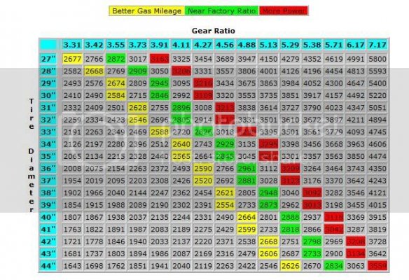

5.13s to only run 35s? With that torquey engine? Nahhhh 4.56 would be more than plenty

As the post said, it was originally for 38s. Yes I do have my torque available at lower rpms! Not the horses though.
Still reasonable power band.
