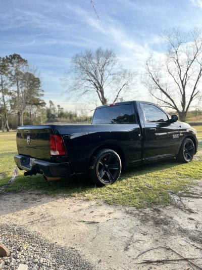

Hey everyone. I hope you all are well. Thanks for taking time to click my link. I have a 2013 Ram 1500 that I’ve been modding. Currently I’m in need of assistance. I have some electrical/tuning? things I’d like to have someone look into maybe a reputable shop or skilled individual in the Georgia area, I’ll drive.
A couple issues are things I maybe created durind the various work i’ve done. To give an example I’m attempting to turn off the coolant señor for the 3 way bypass valve. I don’t have that option on my engine harness same thing with AGS. If I could get help in this area I would gladly appreciate it. In the future I plan on HP tuners but for now I’m AlfaOBD’n it. Thanks again here’s a pic of my truck
