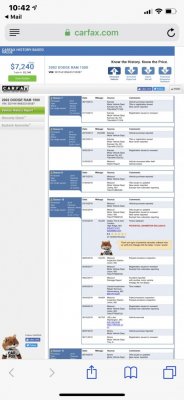

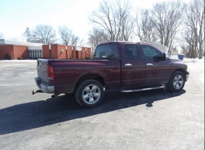

Recently I purchased a 2002 Dodge Ram 1500 4.7 with 98,000 Miles. The truck had quiet a bit wear and tear but not awful by any means. Just a rip in the seat, cracked dash, blower motor resistor. exhaust leak, airbag light, different color hood and some rust on the back wheel wells. After owning it for a bit I started wondering whether or not the mileage was true. Pulled Carfax and last reported mileage was 255,000 miles almost 7 years ago!! which blew my mind because the truck does not run like it has a ton of miles on it at all. It maybe shifts a little slow every now and then but other than that it drives great with no issues. When I pulled the Carfax it did report of a mileage change from 255k to 52k within a couple years but in Missouri and Illinois it is exempt from mileage requirements. Vehicle has a tough history it seems but it passed safety and emissions first try. I’ve tried reading casting numbers and serial numbers everywhere on the vehicle and I have gotten nowhere. I thought maybe it was swapped somehow with a donor truck or maybe rebuilt but it doesn’t explain the speedo being so low. Vehicle has also been in a couple accidents apparently but an airbag never deployed. Engine bay is surprisingly pretty clean and fluids seem to be kept up with. Truck bed looks like it has 300k of wear on it. I cannot for the life of me figure out any serious story of this vehicle. I probably shouldn’t be too worried if the vehicle drives good but knowing how many miles are on your ride is maybe important. I’m going to try and find a way to upload pictures of the Carfax and other reports I was able to pull. To be clear I decided to keep the vehicle after talking to person I purchased from because I do not plan on getting rid of it and by the way reports show they had no clue either!! I’d like to know how long I may be able to drive it without dumping a ton of money into it. Any advice for some peace of mind is much appreciated.

I called the Department Of Revenue and they were able to give some details but not a ton. They included that back about 4 owners ago there was a note from a inspection that the odometer was not working but the last Carfax record stated that the last reported ODO reading with 254K. They said to fill out a request for Vehicle records that costs about $5 and they would send everything they have pretty much to me and I will take about 1-3 business days. Talked to a local dealer and the dealer said to bring it up and they would scan the PCM for the mileage with their WiTech tool to find out more info. We are hoping maybe it’s the original PCM to get more info. Also I went ahead and peeled away at the dash and pulled the cluster and it defiantly seems as if somebody had been in there. At this point I have 100% accepted that this isn’t the mileage on the car but I am trying to find out if the motor has been swapped as well. Everything is pretty clean on the motor and it runs really good with no issues and no lights. Defiantly some wear in there though. The transmission didn’t seem to be in as good of shape as in I found a couple identifications of an older transmission. This thing has drove me crazy knowing all of the history but people need to know if the have 90k or over 300k on what they are driving on the daily. Do your research!!! Even if there isn’t symptoms of tampering there is always a chance!
