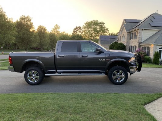

This is the kit that @Quick_Shifter is talking about with some additional parts on stock sized tires. He installed it too. Truck looks great IMHO and drives like a dream.

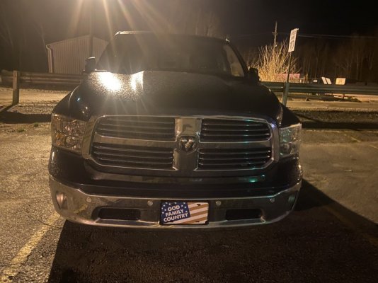

Is that a BigHorn in Crystal Black Pearl and chrome? A darn fine looking truck for sure!
To be honest I think it’s called Granite Crystal Metallic or Maxium Steel Metallic. Either way I want to black everything out.
