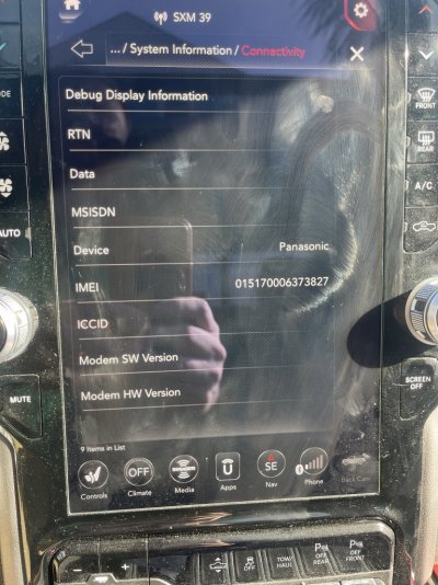

I have the exact same issue on my 2019 RAM 1500 Rebel (as do others: https://www.ramforum.com/threads/gps-not-working.184715/). Called Uconnect support and they had me try a soft reset which didn't work. Brought it to the dealer who did firmware updates which also didn't work. Another tech looked at the Connectivity screen in Dealer Mode and because most of the fields were empty, said it was probably a hardware problem and the entire radio needed to be replaced (~$1500). I opened a case with RAM Customer Service to see if they'll help me out since it's just outside the warranty period.
