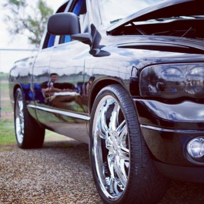

I have an 03 dodge ram hemi that I bought with a flip kit installed and lowering spring up front is what I was told ?, what do I need to make it back to oem?

Here's the truck , shaved handles tailgate antenna roll pan 26s new paint , hids

Lol iv had the truck and did all the work too it except the drop kit , was already dropped but I don't like the look anymore image.jpg

For the front, you'll need the OEM height springs and bump stops
For the rear, you'll just need to flip the leaf springs back over and get the OEM shackles, etc
Also, if you have drop shocks on there, you'll need to get some OEM length ones
