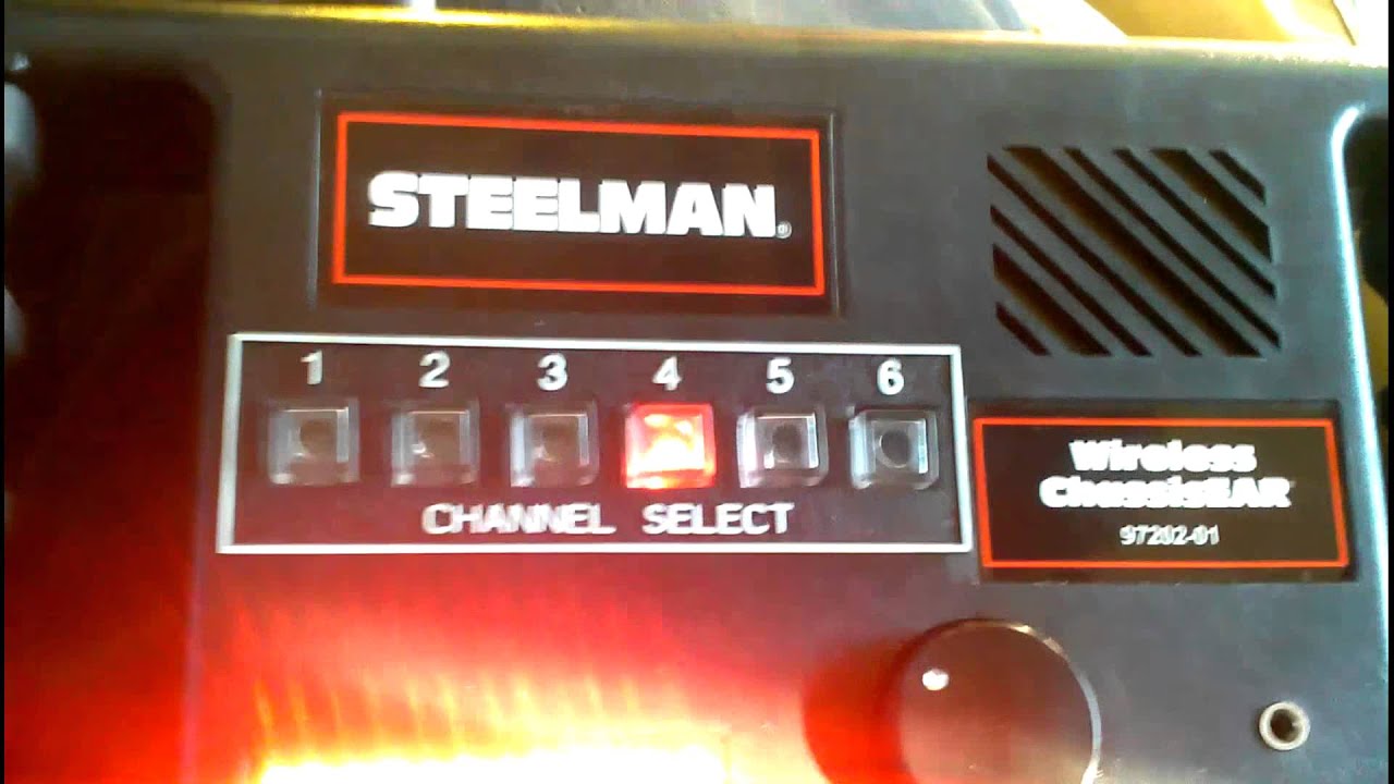

video of Chassis Ears on a Ford
there are several videos that also pop up
one mechanic advised that you don't use the Steelman Bluetooth kit, but other Steelman kit are widely used by shops that look for chassis & body noises.
In one video, they mention that you can listen to the fuel injectors ??
