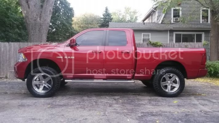

im upgrading my rough country 4inch lift too a 6inch lift and i want to replace the rear shocks what shocks should i go with and do u guuys have a part number ?

i have rear bilstein 5100 but i feel like they are to short
anyone have any input
