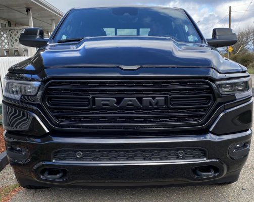

*** Update ***
Took the truck to an automotive electrical guru and he connected his scanner up. There was like 20+ codes so he cleared them then couldn't reproduce the error. I drove around for another week and nothing popped back up. I couldn't get it to error out so.....
... I traded it in this week on a 2022 Limited Night Edition fully loaded.
Not my problem anymore.
