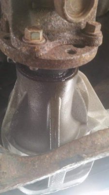

Hello all,
I have a photo showing where there is a leaking seal at the front of the driveshaft. I don't know exactly what the terminology for this seal is, and if anyone could offer some input it would be most appreciative.
05 Ram 1500 4WD 4.7L SLT

Front Pinion seal

Hello,
Thank you for providing that information. I will research it further, but thought it may be an input shaft seal after research. Do you happen to know where the best place to purchase this with highest quality is?

Local parts store usually has several grade level of seals, ask for the best they have and if you don't like it go to another store and see what they have. RockAuto also usually lists several to choose from.

Hello,
That's the pinion seal...as it's where the driveshaft yoke attaches to the pinion gear.
