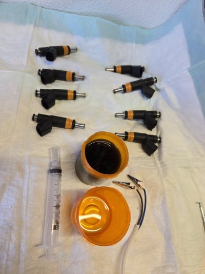

Mikes right i'd be doing at the very least a home clean job on the injectors and check their spray pattern.
Google how to clean injectors at home.There's a pile of video's showing how to use a battery and injector cleaner to clean injectors at home.Watch a couple of these video's.
Quite impressive how much carbon was inside the injectors. I will never pay for "fuel injector cleaning" again. Thanks

If you missed this thread,it has the rebuild kits and how to rebuild the injectors at home,i also posted a couple pics of my old cobbled together kit for cleaning them. I usually use Carb/Choke Cleaner followed up with a Brake Clean flush,and i flush them in both directions. I've never used the syrnge method,but i'm sure it works as well as the other DIY methods do

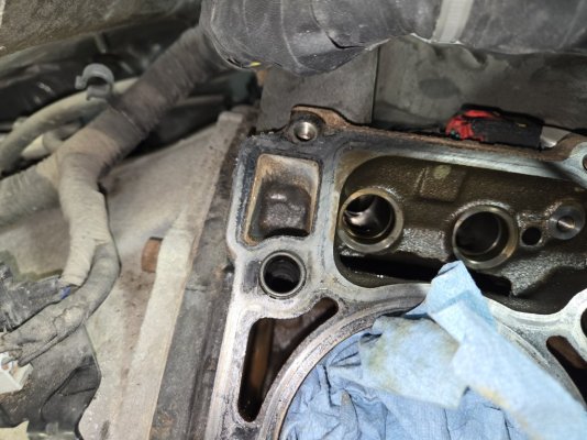

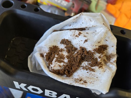

Started on block and found this. Assuming it the coolant passage and was blocked. 1st pic is location. 2nd pic is what came out. 3rd pic is opposite side. Just clean it, vacuum it and the drain and flush system?
What would cause this? If motor was running fine before I found this, should there be a concern?

That looks like a high milege engine that was running closer to straight water then the proper 50/50 mix of water and antifreeze. See if you can get the block drains out of the side of the engine and flush a bunch of water through it,and to make sure water actually runs out the block drains.If nothing comes out the block drains,you got issues

I believe it is casting sand. There's nothing in there.
You can get at the passenger side block drain pretty easy,see if you can remove it and see what comes out of the bottom of the block.I'd also pull the drivers side block drain,but you have to remove the starter to get at it,i have pulled the drivers block drain once with the starter installed,but it's easier to just drop the starter to get at it.

I pulled passenger side. It came out pretty good. I the use syringe and withdrew all the coolant I could see from top side. There was a little mix of coolant and oil (assuming from removing heads). I see why you need to drain oil afterwards. I ran fiberoptic scope down coolant jackets and just looked around in the block and bit. I can see some sediment down the water jacket holes. Just from the passenger side, I am thinking about good flush (or several) will clear it up. We'll see what happens when I do left side.

Once you get the block drained,you could carefully fill it up with a bunch of CLR and let it sit for 24 hours,then flush it with water.Use a funnel to pour it into the water jackets.Stuff rags tightly into any lower coolant holes that the clr would run out of
