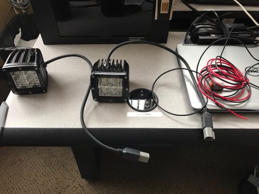

These are the pods I will be installing any help would be greatly appreciated

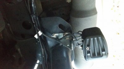

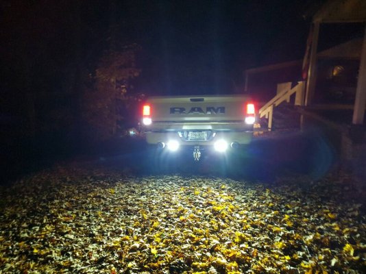

ce79db1002e4570ab867ded532bd8800.jpg273321dc267532ea80427f145dc70c77.jpgI used some 5" L brackets and pre existing holes

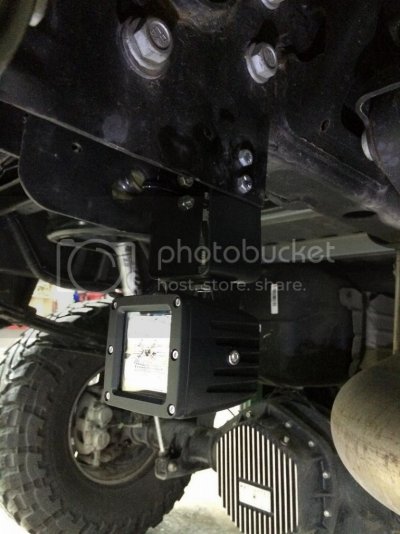

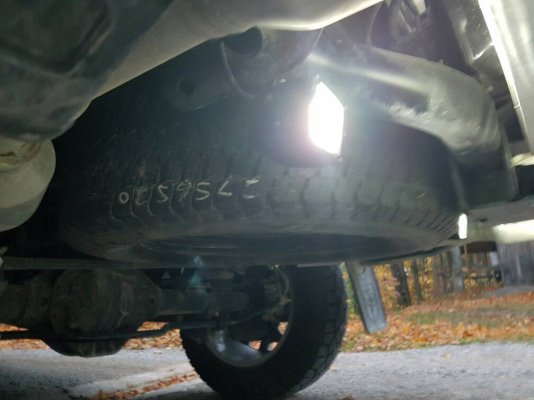

Couple of galvanized corner brackets from Home Depot...

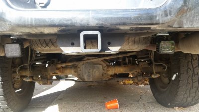

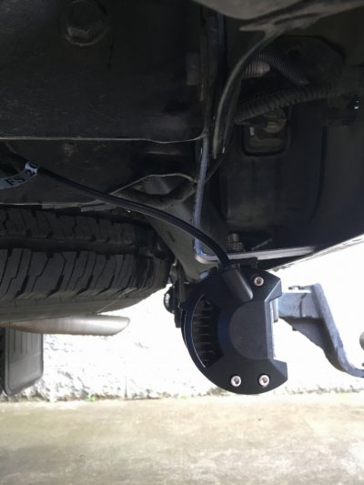

I drilled holes into the hitch receiver frame and bolted the lights up there. If I could do it over, I'd do the corner bracket like others in this thread have done. That way they'd be straight, and I'd get a little more output. Wish I had thought of that! Lol
Sent from my SM-G930W8 using Tapatalk
Out out still looks really sharp tho!

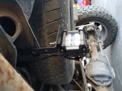

L brackets from home depot, painted flat black

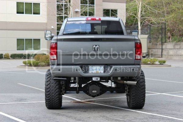

Oh wow lol am I the only one with theirs installed into my bumper ?

Flush mounts look great....... I just didn't have the balls to cut into the bumper
