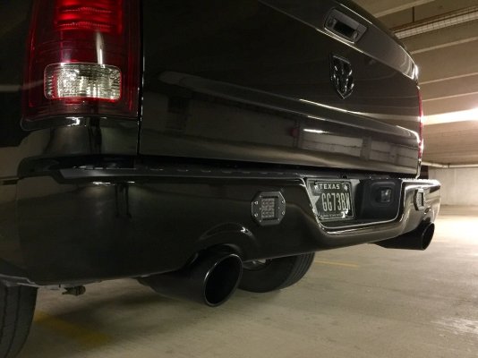

Nice, where'd you get them? I tried ordering the Rough Country flush LEDs today via eBay and twice, after the order was complete, I had the transaction cancelled because they're out of stock.
DRkNESS
Apr 24, 2012
5,810
3,409
South Jersey
Which tips are these please as I'm looking to add black ones to my catback Borla exhaust ?

Flush mount is really the only way to go to look factory and look 'right' - it's not hard to drill 4 holes and connect the dots with a jig saw.
Old or new.. I did this to my truck when it was new as well as roof lights.
Man up! :)
Just a warning - the lights picture above will not work for flush mount. You'll want a light that had a bezel.
