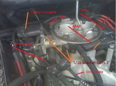

When cleaning the IAC pintle do not pull it, twist it or mess with it at all, just spray it off with carb cleaner and wipe it off gently. It is best to remove the TB and clean the IAC port as well.
Here this might help you find it.

thank you guys much and that picture should definitely help! and now just to see if i can figure out exactly how to do this lol Thanks a bunch guys I shall post an update

oh man thank you so much that should definitely save me a few $
