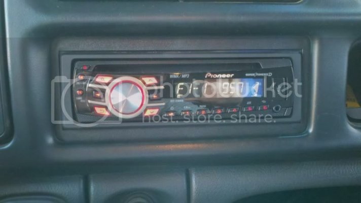

Got it...couldn't have done it without you guys...appreciate the help. The color to the stereo wires were different than what the wiring diagram showed. I'm not sure what the guy who had the truck before me did but it was a mess.

hey that's just like mine!
only have a night pic on my phone right now lol
