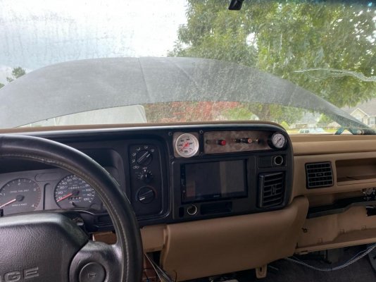

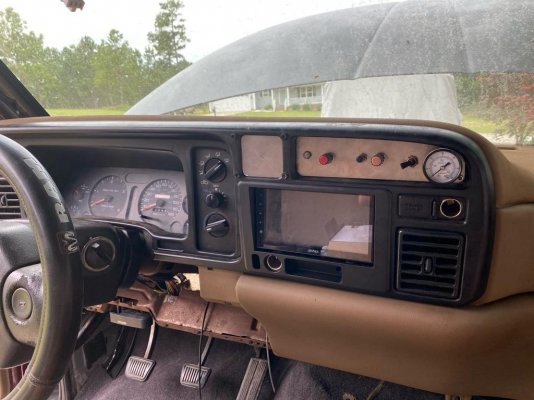

I just noticed you did something unique with the cup holder opening... what did you do? Looks like some gauges and lights or buttons? I still have my cup holder but don’t plan on using it.
Yeah, so my truck is a diesel. The knobs and the switch tune certain aspects of the fuel and turbo, and the gauge monitors the overall pressure in the system. It is a good place for auxiliary switches though. Just a simple piece of steel from Lowe’s. I used a piece of cardboard to make the template, and used the existing screw holes in the bezel for mounting points. I also added a mechanical oil pressure gauge to that little cubby just to the left of it.
