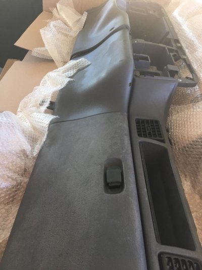

I received my “new” dash today[emoji3].Definitely NOT the one in the picture on e-bay.Looks pretty faded, has a few hairline cracks that will probably grow when I try to wrestle it into the truck[emoji53].
But... that being said still much much better in the instrument attach lattice than my old one.
I am replacing all the blend doors and blend door actuators, blower motor and blower motor resistor while I have everything out.

Here is the dash I got:

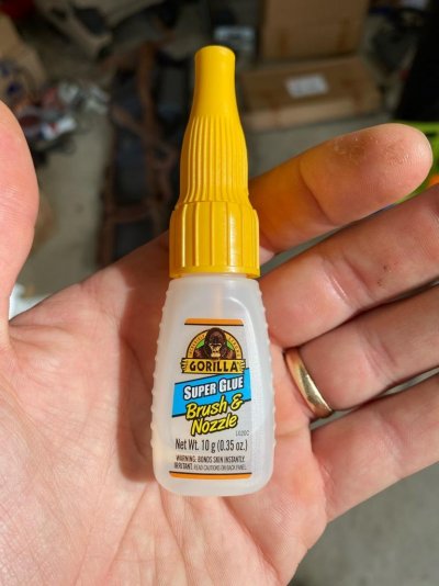

Hot glue didn’t work lol. Unless I didn’t have the right kind. As soon as it dried, it pretty much peeled off. Got this stuff:

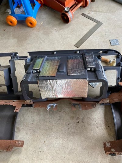

It worked very well at reattaching broken pieces. Here is my application of the Noico 80 vibration dampening stuff. Huge improvement so far IMHO:
That looks good! I’m glad you tried the hot glue and reported back. That sounded like it could be a winner. I looked up plastic welding and that looks like it might be good - but I think re-enforcing is necessary for success.

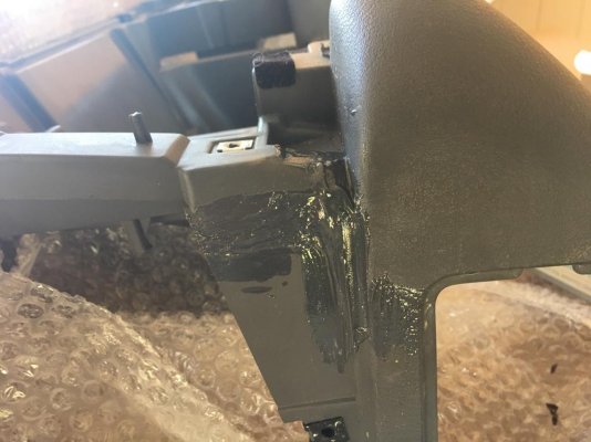

I used a product today by JB Weld called @ quick weld”. It did good.
Not so pretty but I hope I can sand it a bit if everything else goes well.
