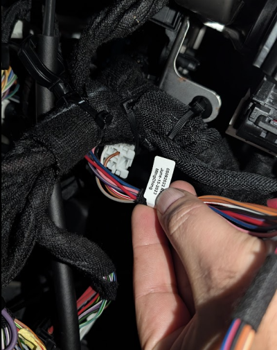

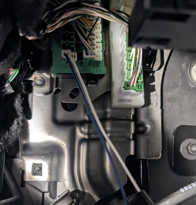

Looking, poking and probing, I can across a few posts in this site about alfaodb, among others, and the need for 2018+ 1500 requiring a bypass.
While search through that stuff, it looks like such a bypass goes into a gree plastic connector behind the dash higher up and above the obd port.
I took this pic of the wires under my dash, and this pair of wires plugged into that green port is part of the extra obd connector port I found in there too. I'm assuming it's spliter and it contains the bypass stuff.
Can anyone confirm this is a good indication that this after market running board does in fact tap into such bypass? It's the white and blue pair that is connected to the harnesses that are plugged into the obd port.
While I like the running board, if it means a dealer may try to tell me my truck is no longer covered by the warranty because of this, I rather take it all off before I have to take it in for any service.
I rather pay for the OEM, or just a pair of good old fixed step bars, and call it the day as I don't really need fancy retracting steps. My warranty is more important to me.
I appreciate the help very much.
Edit: did more googling and it seems that blue/white pair is connected to a star connector and it's the one for the C can bus. Not sure if it relates to anything with security implications or not.

More pics from under there.
These are the cables that get disconnected and then connected to the bypasses?
I am not sure what this is for
At first I thought it was a odb pigtail, splitter, or passthrough, but it's connected to this:
And that connector up there I don't know what it is.
It might be the controller for the running board, but it got kind of dark and my flashlight's battery died on me. So I'll take another look tomorrow to confirm figure that out.

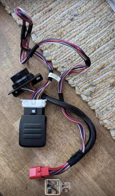

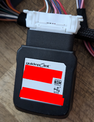

Found what that extra odb harness was for. This was tucked way up there, could barely see it.
Looks like a tracker. The kicker is that if this is for my lender to track the vehicle, the people at the dealer left the info booklet and install instructions that comes with it in the car.
Unless they want the buyer to activate it and think they're the only ones tracking the vehicle and the bank gets it too.
Only conspiracy theories folks, but I do not recall anything in all the paper works I signed for this track about this track guidepoint thing. So for now, ti's going to stay out of the truck until I can figure out what it is.
To clarify, it was I who put the red block over the scan bars, EMEI and other numbers on the unit, so that one thinks it was the dealer who put them there over the unit in case it's not readily apparent it was done after I took the picture :)

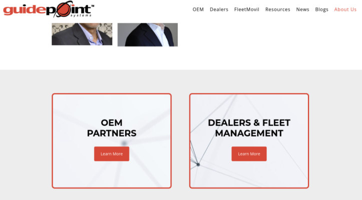

Yup. Website contains nothing about end user, only oems, fleet management and dealer partnerships.
I did some more digging and found an ad on their sales site.
https://www.guidepointsystems.com/dealers-fleet-management/
" Easy to Install – No Cut or Spliced Wires "
I also see the bullet point that says, " Promotes Retention by Driving Traffic Through Service Retention and Dealer Website"
I'm guessing that this is evidence they may be sending check engine light notifications to the dealer. I've gotta take this thing out. More people should know about this. I wish there wasn't so much fine print these days, because I almost certainly agreed to this somewhere.

Jokes aside, what you are probably looking at is an ancillary product that was installed by the selling dealer as part of an ancillary product package for theft protection. The selling dealer maybe had intentions of charging for it, you may have paid for it( I don't know). Remove it and smash it.
O
orange
Aug 17, 2024
33
12
MA
2023
I'm trying to figure that out right now. I removed it and took the truck for a drive. All the app geofencing alerts and remote features like turning the truck on/off. locking/unlocking still work without it.
I already reread all the documents I have that were signed and given to me by the dealer and there is nothing in any of it that points to a device like that.
Best case scenario: we install this theft tracking device in all our new vehicles and because this was one left in the lot for so long we ended up forgetting about it.

I did call. Waiting for a call back.
The reason I posted here was that maybe someone has seen these things installed in other cars and they knew what is used for.

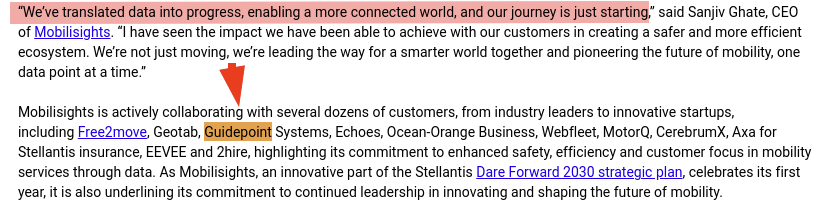

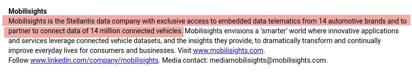

For example, I found this, which basically says Stellantins works with GuidePoint to collect telemetry to "improve customer experience" (as opposed to "we gather that info and make money on it, but we do tell users it's to make life better for them, and they pay us a monthly fee for selling us their info"). Dated January 10, 2024.
Full story here: https://www.stellantisfleet.com/new...r-advances-in-mobilisights-mobility-data.html
But after I pulled it out of the truck, I took it for a drive and all the connectivity stuff still works just find, including geofencing alerts, start/stop via the RAM Connect Phone app and all.
So it's not the telemetry stuff the car has already built in (that cell modem is in the head unit from what I've been able to find). And from the mopar parts site the telemetry module looks different too.
We'll say what the dealer has to say about it, if they return my call at all.

Two different things. What you found and removed is an aftermarket tracker that the dealership (or someone else) installed.
The radio connectivity (Ram Connect, etc) is different, and handled by the telematics box behind the upper glove box. To remove all connectivity with stellantis, you would remove that telematics box, and use alfaobd to configure the BCM so it knows it’s not there anymore.
I thought that was the case too, but a while back when 3G was turned off all over the place, connectivity in every car that used 3G stopped working.
I tested this because I wanted to makes sure the car did not have an older 3G setup and this was added as a cheaper work around then redesigning the entire system to use newer tech. The chances of this were very, very slim, but I wanted to rule that out before contacting the dealer and getting a response that that's what it was.
Still waiting for them to get back to me on this, though the internet sales directory did reply to my email saying he'd get the answers for me.
I'll be turning off the car's built-in telematics as soon as the OBD dongle arrives from amazon.
But good thing you brought that up. The way I read what you wrote about the telematics thing makes me thing it's not enough to just turn it off with alfaobd, but removing/disconnecting the module is also necessary. Is that actually the case? Maybe if it's left connected the system will think it's something wrong with it? I can remove it, not a problem, just trying to clarify the entire procedure.
