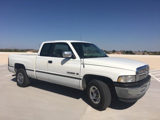

Welcome to the Forum! My 5.9 had the “stumble” for years. Happened only once in a while , got more frequent then less frequent. Didn’t throw any codes!
Tried all kinds of things to fix it. Replaced fuel pump, IAC, cleaned throttle body, new plug wires, new plugs. In the mean time the alternator went bad and rear diff had to be rebuilt. Nothing fixed it. Anyway, long story short...the engine just died one day on the freeway and it was diagnosed as a bad ( either camshaft or crankshaft - can’t remember which) position sensor. I had both of those replaced along with the distributor cap and my truck (March TOTM !![emoji38][emoji38][emoji38]) has been running GREAT. No more stumbles!!
Good luck with your classic Gen 2!
P.S. My engine has 330k miles!
I replaced my dashboard, too!
