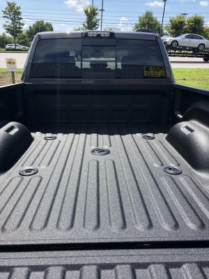

The 1500 i bought didn't come with a bed liner, but i talked the dealership to install a RAM brand name plastic liner (the standard kind you see on lots of trucks, not spray on).
I noticed just below the rear window (the little window that opens electronically) the bedliner has a slight bulge in the plastic. if you push on it, it flattens out and looks normal. i asked the dealership and they said its because it has to adjust to being in the truck because it was stored and has to 'flex'.
is this true? how long do i wait to see if the bulge flattens out? its about 10" wide and again, if you push on it gently, it flattens out. kind of like a bubble.

It's probably just from storage or shipping. Let it out in the heat for a bit and it'll relax and straighten out.

If you have a heat gun you can use that to heat it up and then flatten it.
Just hold the piece that is heated down with a flat item until it cools.

As stated, let it sit in the hot sun and it will smooth out.
