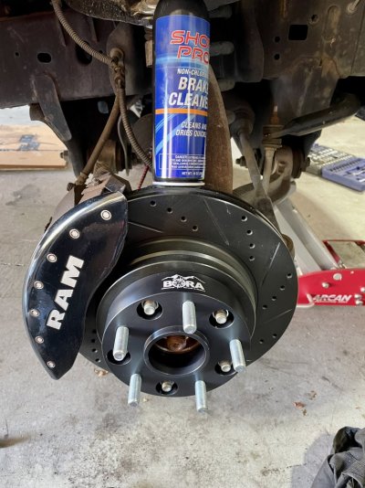

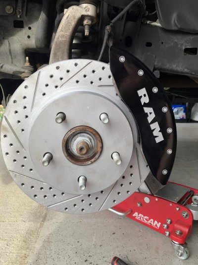

I did R1 Concepts Geomet rotors and ceramic pads all around in 2019. They performed excellent. I just in the past few weeks replaced the R1’s with Hart Black series rotors and ceramic pads for just over $400. Brake jobs are easy. This is a must if you have oversized, heavy tires. Slotted and drilled rotors and good pads make a HUGE difference in performance.
Hart Black from 12/2022
R1 Concepts from 2019

Dang! I complete forgot those images of mine were used! Im famous LOL!
R1 held up very well. I had a state inspection a month ago and the pads all measured 3-4mm, so they lasted prob 40,000mi. Never a squeak either, low dust.
yessir, those pics you provided were too good not to share with the world lol
