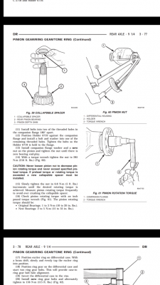

Can you explain to me how you get 20in lbs of preload on the pinion nut and still torque the pinion nut to 210ft lbs. I understand that it's 20 rolling inch lbs, as in 20in lbs of force needed to rotate the assymbly but will the preload be met when you torque it down to 210ft lbs. Or is there some trick to torque it to get preload to 20in lbs and then another way to torque it to 210ft lbs with out increasing preload torque?
If you are using the stock set up there is a crush sleeve between the pinion bearings. As you tight the nut and it takes about 300-350ftlb of torque to crush the sleeve. You keep tightening the nut and crushing the sleeve until you get the correct rolling preload. The 210 torque is the torque you torque if you are replacing the pinion seal. This torque allows you to tighten the nut to a torque that is tight but since it us well below the torque that is required to crush the sleeve. so torqueing to 210 will not change your rolling preload. If using the shim style pinion setup you add or remove shims tight the nut until you get the right preload, when you torque this set up you will tight against the shims between the pinion bearing.
So when new bearing and a new crush sleeve are installed.l, and rolling torque is achieved the pinion nut should be all goo to go and not messed with anymore correct? And pinion depth should be the same as before cause you are following the same crush depth on the sleeve with the same rolling torque as before?

Screenshot_20180426-175337.png Screenshot_20180426-175200.png but I also see this in the service manual and it says to tighten to 210ft lbs first then 5ft lbs increments till rolling torque is achieved.

Yes, I just rebuilt mine. When you torque to 210 you'll have .125 of end play with a new crush sleeve. You keep tightening and by the time you have the end play gone and you have the correct rolling preload the torque is 300-375 ft lbs of torque on the nut. I used a 3/4" ratchet and a cheater pipe. The instructions are not very clear. They also tell you to tighten side bearing caps to 75-100 ft lbs after you get .003 backlash then tight the right side bearing until you get the correct backlash- and when are done you should have 75 ft lb. But if you do that the side bearing races will not slide in the housing even at 75 ft lb. I had to loosen slightly the bearing cap then adjust. After backlash was set- I gave the cap bolts and did a final torque then rechecked backlash.
