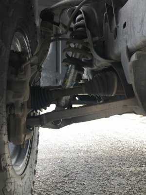

z man do you mind posting pics of your cv axle? I just want to see the angle (if any), the cv axle is at with the bils set at 2.8. I have mine set at 2.1, but considering of going 2.8. Thanks!!

How’s that? I think the most thing you’ll notice is because the strut spring is compressed more, the ride is more firm

what's a bad Cv angle look like?
