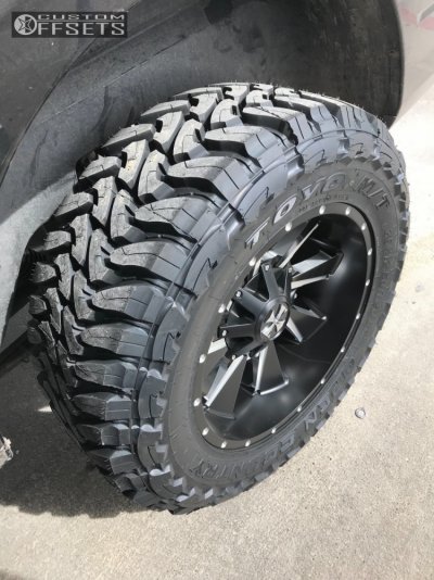

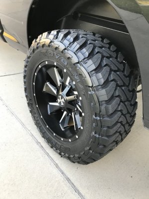

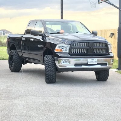

My '09 Ram needed some major TLC so I installed Bilstein 5100's on all four corners. The front's are adjustable and set to 2.8" but it lifted it a solid 3". The rear has 2.5" spacers on the coils (top and bottom of spring). I then added a 1.5" Zone body lift for a total of roughly 4.5" of final lift.
Toyo 35x12.50 Open Country Mt's on 20x10 Cali Offroad Distorted's
ZERO scrubbing whatsoever and the ride is fantastic with the new shocks and struts.
Here's the link to CUSTOM OFFSETS page I have all my pics and a video
I just wanna say Custom Offsets I had randomly come across googling tires and man that site is the best idea. Everyone lists what they have installed as far as lift and width of rim with what backspacing and list any kind of trimming or rubbing or whatnot. Highly recommend.
**QUESTION** I'm finding out that I need about 48 psi up front to get the tires to sit nice on it's tread but the rears seem to want about 32 psi with how light the bed is, otherwise the rears tread wont touch all the way to the edge. What do y'all suggest?

Can you overinflate that much and not affect your wear pattern? Usually going too high will wear out the center tread before the edges.

Wow that looks great and it’s only bilsteins set at 2.8? And spacers in the rear?

Do you know what the top of the truck height is?

Looks great! I was told to run 60 PSI in our 35” Toyo Tires. That is what I have been running.
Curlyp
Mar 17, 2017
1,189
451
OH
Def don’t need anywhere near that high of psi. These mt’s sidewalls are much stronger than a at tire. I wouldn’t even run a at at that high of a psi.
Oh wow. Then the guy lied to me. Thanks for the info. By the way I have the R/T version of the tire.
blackbeautyhemi
May 19, 2013
2,190
1,317
Lewistown, PA
That still shouldn’t matter. They have a 3 ply sidewall just like their m/t so it’s a good stiff sidewall. If ya put too much air in it rounds the tire from inside to outside and you’ll wear the center section out way faster than the outer edges.
