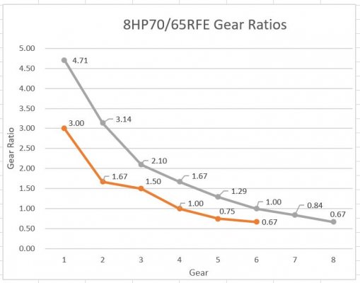

You guys with 8HP70s are making me so jealous. Do y'all know how much tire smoke I will make when I get done putting mine in place of the 65RFE??
Why the hell would anyone want to lock out 8th gear??? You guys need to think of the 8 gears as a close ratio 6 speed with dual overdrives. Your 6th gear is direct drive, so you get five underdrives, one direct, and two overdrives. That is amazing. I'm getting hard just thinking about it. Like compare that to a 4L60: it has two underdrive gears, one direct, and one overdrive. The 8spd has three more under-drive gears AND another over-drive. That is amazing.
You can pull anything with that much gear, it up-shifts sequentially, it can do massive 5th to 1st downshifts, has a 500ftlb torque capacity, and has an amazing compound planetary design with four planet sets, three clutch sets, two brakes, a super efficient pump, and shifts ultra fast. They put the same transmission in Bentleys!
It's an amazing transmission. The Hemi is an amazing engine, and the lifter issues are way over-hyped on the internet. The coil spring four link rear suspension is amazing. The aluminum SLA front suspension is amazing. If you REALLY keep your foot WAY out of it and put in 3.92:1 final drive you might see 18mpg average IN TOWN with MDS, and that is AMAZING! You have an amazing truck.
The quick answer is: you're not pulling anything of substance with the 5.7 in 8th gear with the 3.21. It physically cannot do it. If you're going down hill for a few seconds it might upshift from 7 to 8, which is a wasted shift because it will downshift again a few seconds once you're back on level road. Locking out prevents needless shifts.
With my trailer and a moderate/strong head wind? Forget 7th as well, I just lock it down to 6th and let it run at 2300 rpms, it will do that all day.

oh yeah, you def wanna ditch that 3.21:1 final.
Actually, come to think of it, my 65RFE's "6th" gear is the same ratio as the 8HP70's 8th, and I pull a 20x8.5 enclosed V-nose trailer that weighs about 6500lbs with the tools and car in it. I used to have the 3.55:1 final and it would use 6th on the highway unless I was trying to climb a hill. I'm betting the 3.21:1 gears would be a total dog in that gear with that kind of load. I bet the 8HP70 trucks with 3.21 final will drop to 6th gear all the time, which is probably pretty annoying. When I went to the 3.92:1 final gears I discovered how the truck was supposed to run and then scratched my head wondering why they even bothered with the 3.21 and 3.55 final. Mine cruises just fine at about 2500rpm at 85 or 90mph, it's totally tolerable and sometimes goes into MDS at 90mph. It's really wild when it does that on flat ground, and I usually try to see how long it will stay on four cylinders without losing much speed. I can't wait to change to the 8spd, I am SO excited to see what that feels like.
... I'm betting the 3.21:1 gears would be a total dog in that gear with that kind of load. I bet the 8HP70 trucks with 3.21 final will drop to 6th gear all the time, which is probably pretty annoying. ...
Nope; I have the 3.21 and it pulls in 6th at 2300 rpms all day, and without a strong headwind I can drop into overdrive/7th as well.
If you have the 3.92s, you're still going to need 2300 rpms with a head wind; only you'll be in 7th instead of 6th like in my truck. Don't fear the rear axle, it's completely irrelevant with todays 8 and 10 speeds.

Both the 65RFE and the 8HP70 have .67:1 top (second overdrive) gears, and .76:1 first overdrives. On the interstate the final drive gears directly affect what RPM you cruise at in top gear, which means if you change to a lower final gear, you will do more rpms in ever gear for a given tire size. With either transmission, in top gear at an 80mph cruise with 3.21:1 final you'll cruise at 1800rpm, if you change to the 3.92:1 final you'll be doing 2200. These numbers were calculated with my 31.5" tires. If you have 33" tires you'll want a 4.10 final to get the same result. The final drive ring and pinion are THE determining factor on what gear you can cruise in if you need 2400rpm and don't want it to hunt around.
That's all completely beside the point; my point was, a 3.92 will not pull harder once you're already out of second gear. If my truck needs 2300 rpms to pull my trailer, a truck with a 3.92 will still need the same amount power; 2300 rpms. It will just be in one numerically higher gear than mine (7th instead of 6th).
Your looking at it backwards, what gear will I be in... you need to ask instead what power/rpms do I need, and the transmission will work with whatever gear ratio you have to drop you into the gear you need to get to 2300 rpms.
In other words; don't worry about rear end, it's completely pointless when you have 8+ gears.

The 65RFE also has 2 overdrives, although the lower gears are not what I would call "optimized". There's hardly any difference between 2nd and 3rd. Very strange, but it is what it is. The shift points are also very strange unless you drive in "Tow/Haul" (Sport mode). I have made "Tow/Haul" my default and it has made the truck much more enjoyable to drive around town. For the rare road trips, it's easy to press the Tow/Haul button to disable it so the transmission can utilize 6th gear. See below chart for a comparison between the 8-speed and 6-speed transmission gear ratios.
I have the 3.55 rear end and think the 3.00:1 first gear ratio works great even though it's not near as low as first gear on the 8-speed tranny. Just wish second gear was something more like 2.10:1 instead of 1.67:1.
