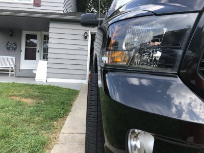

If this helps, here are 1.5” wheel spacers on the stock 20” wheels on my classic. Since you have the warlock flares it would be just about flush on your truck I think.

And also for reference, this is 2” front 1.5” rear level
